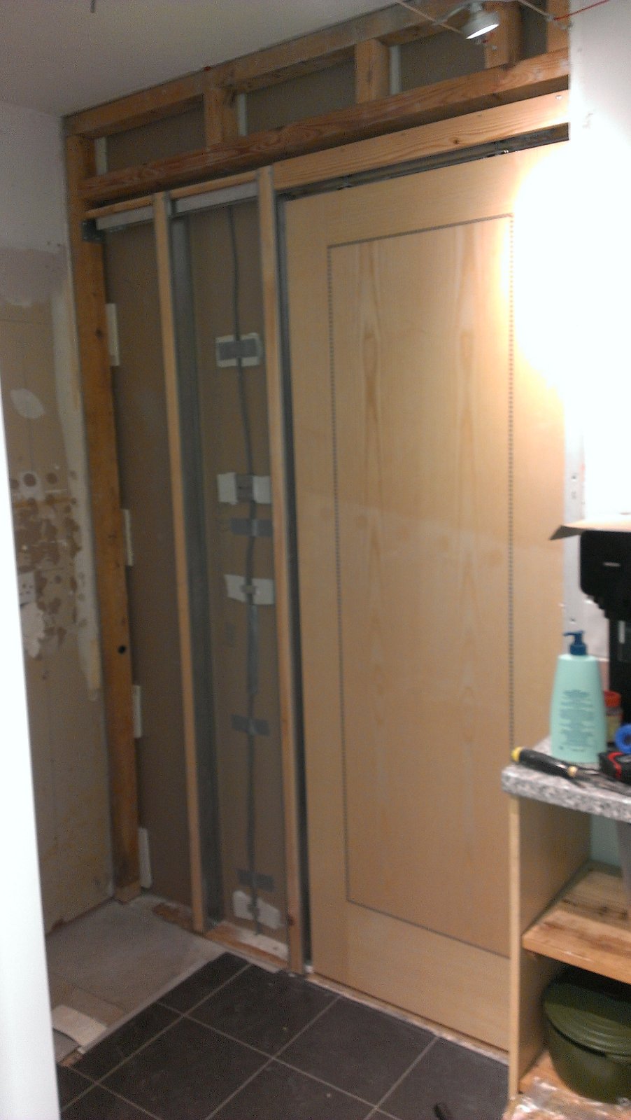

This weekend's project... installing a door in the kitchen. For various reasons we wanted a sliding pocket door - but first you've got to create the pocket, so down came the stud work and in went the new door. Also wanted to modify the electrics so that we had switching for the kitchen lights from the hall (rather than as at present where a trip across the dark kitchen was required!) and make both the lights in the hall on one circuit with 2-way switching. Plus, as it's a fire break, adding a heat detector in the kitchen, and replacing the smoke detector in the hall, and linking all together with the detector at the far side of the house.
Door, ready to box up the second side, with the careful tie back of cabling - there's not much room so the cable had to be well restrained to stop it fouling the door.

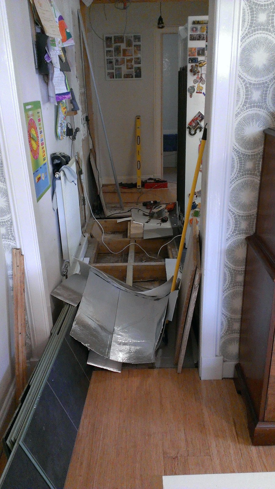

Which meant that at 10.00 on Sat morning, the end of the kitchen looked like this as the cable was pulled....
By yesterday evening it looks like we are getting there....
Still some way to go with finishing off.
Oh, and it's best to be REALLY sure that the wire you about to cut, is, in fact, as dead as you think it is
Fortunately the RCD did its job and it was no more than a small fizz. No idea why the wire is live - it was not connected to anything in the light switch (and I thought I had confirmed it dead with a circuit tester). Now terminates in a JB with LIVE written on it large!!

RichardW wrote: 02 Oct 2017, 12:40 Oh, and it's best to be REALLY sure that the wire you about to cut, is, in fact, as dead as you think it isFortunately the RCD did its job and it was no more than a small fizz. No idea why the wire is live - it was not connected to anything in the light switch (and I thought I had confirmed it dead with a circuit tester). Now terminates in a JB with LIVE written on it large!!
Possibly it isn't live.
RCD will panic and cut off if you touch the neutral to the Earth after you turn off the power.
Thats because the Breaker only acts on the Live so when you cut the cable some current will be detected on the Neutral which freaks out the RCD because it doesn't see the same current on the matching Live.
When you say a small fizz did you'r cutters get a little hole blown in them? If they did it's definitely not what I said and you have a weird live wire.
