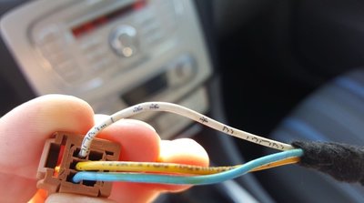

I am sorry, I made a mistake. The Brown connector from the new display has three wires and not two. Unfortunately I cannot read so good the numbers but I can attach here the photos.
What do you suggest? To use the pinout exactly like in the link from the first page of this topic?

No, that's good, just plug it in - As you can see from the 3 wires I have highlighted below, the power and earth seem to go directly into the Head Unit and the third Rheostat wire goes off to the other side of the unit - but I can't see a separate connector for that - hence my previous thoughts.
So you have what was expected - so you should be fine - but ALWAYS disconnect the battery following the BSI / battery reset procedure before disconnecting any of the head units.
Close the doors and leave window down, wait 5 minutes and then disconnect the battery negative terminal and ensure it does not make contact again. wait for another 5 minutes and then replace the units and connect up the wires. When all is in place, close all the doors, wait a couple of minutes and then reconnect the battery and wait for 2-3 minutes without opening the doors or touching anything. Then you can follow the rest of the procedure, check the locking and unlocking etc.
Then check your configuration in Diagbox if necessary. Let us know how it goes.

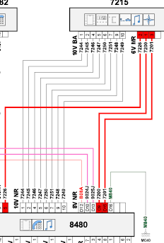

So this is for an X7 with RT6, with independent telematic unit, without hands free kit (calls handled by RT6 bluetooth):
However, as I said and as you can see this is a different layout from the previous diagram - as these brown connections seem to go into the 8 pin black socket, but the pin outs would agree with Pins 2 & 5. - Yet, this dodn't work with Vborovic - so as long as the power pins are correct, you may need to just try it and see what works.
Brown from Display:
7226 control of the display rheostat
7201 : Colour screen earth
7200 : Colour screen power supply
(Click to zoom)

Thanks a lot for the diagram. I will start first by installing the two wires and leave the third one which is for rheostat. I am not an electrical engineer, but mechanical engineer, so I do not know what a Rheostat is. Perhaps can this be used to start and stop the coolers?

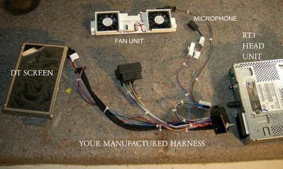

And here a photo: seems that the fan unit is connected to the nav itself but what pins?
http://www.olteanucosmin.ro/rd4_to_rt3.pdf
