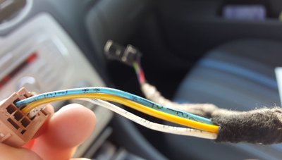

I am sorry, I made a mistake. The Brown connector from the new display has three wires and not two. Unfortunately I cannot read so good the numbers but I can attach here the photos.
What do you suggest? To use the pinout exactly like in the link from the first page of this topic?

No, that's good, just plug it in - As you can see from the 3 wires I have highlighted below, the power and earth seem to go directly into the Head Unit and the third Rheostat wire goes off to the other side of the unit - but I can't see a separate connector for that - hence my previous thoughts.

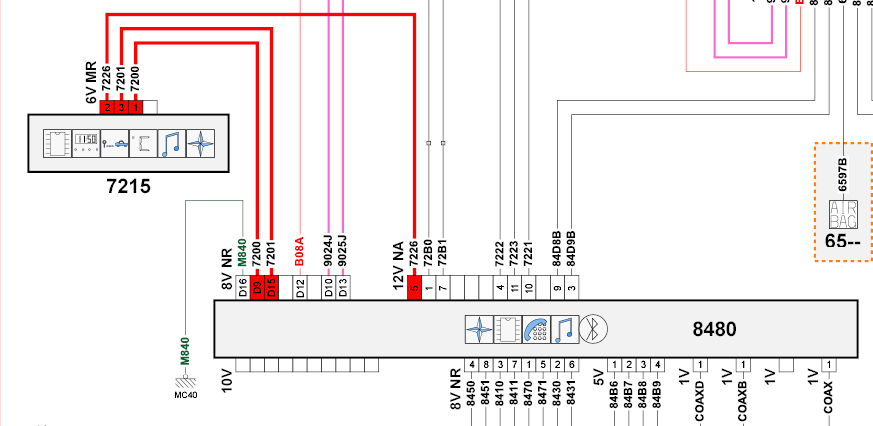

So this is for an X7 with RT6, with independent telematic unit, without hands free kit (calls handled by RT6 bluetooth):
However, as I said and as you can see this is a different layout from the previous diagram - as these brown connections seem to go into the 8 pin black socket, but the pin outs would agree with Pins 2 & 5. - Yet, this dodn't work with Vborovic - so as long as the power pins are correct, you may need to just try it and see what works.
Brown from Display:
7226 control of the display rheostat
7201 : Colour screen earth
7200 : Colour screen power supply
(Click to zoom)

Thanks a lot for the diagram. I will start first by installing the two wires and leave the third one which is for rheostat. I am not an electrical engineer, but mechanical engineer, so I do not know what a Rheostat is. Perhaps can this be used to start and stop the coolers?

The rheostat in this application is used to increase or decrease the display back lighting (like for your instrument display). But as I already said, the colours and display can be adjusted in the configuration menu directly - so that is probably why it is not needed.

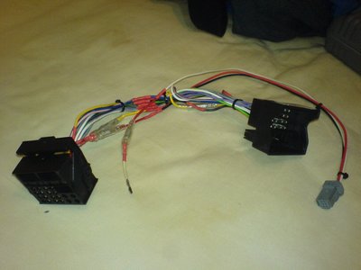

And here a photo: seems that the fan unit is connected to the nav itself but what pins?
http://www.olteanucosmin.ro/rd4_to_rt3.pdf
