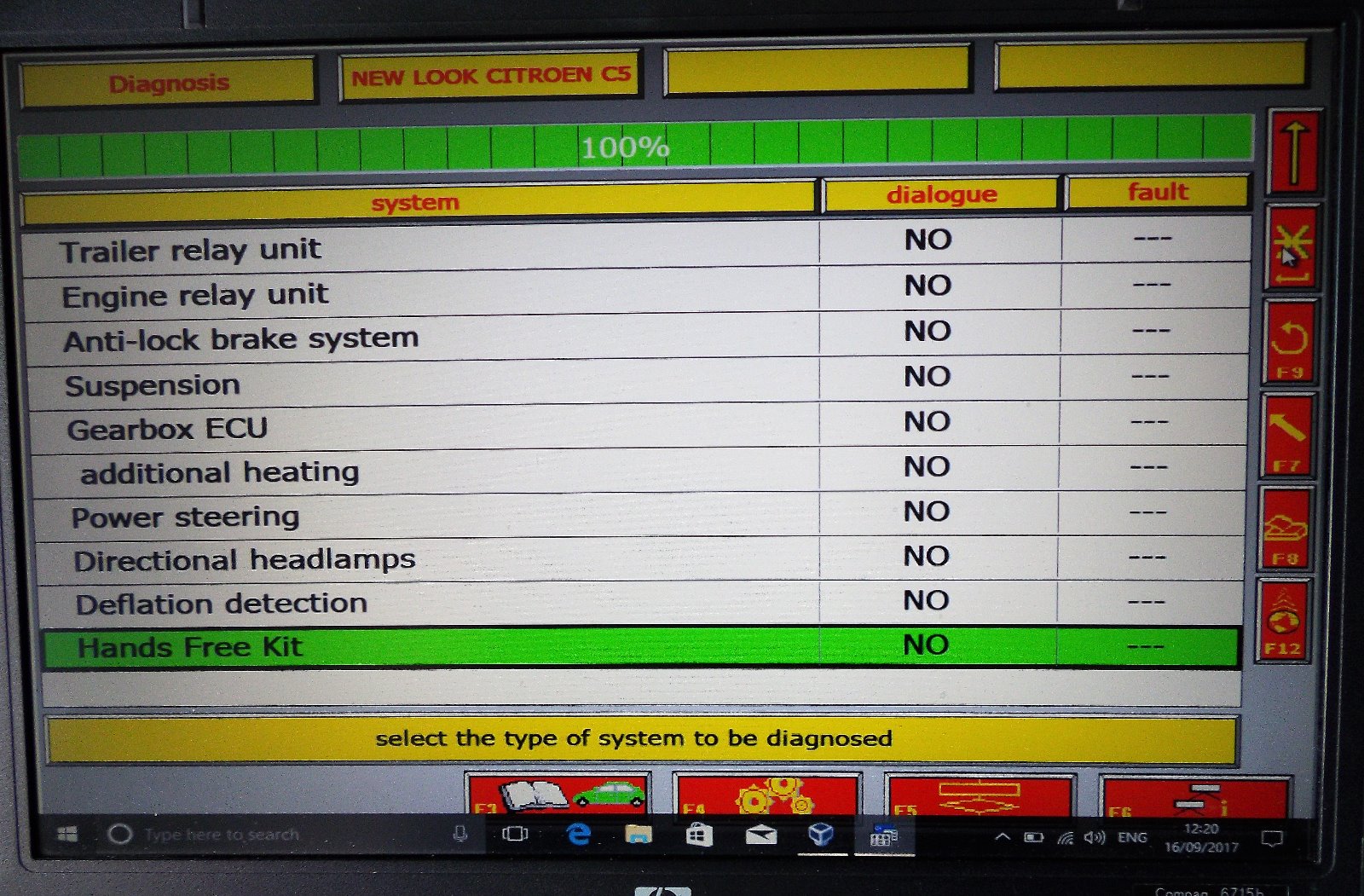

So, I put the old Dell laptop aside, installed a VM with XP on my Win 10 HP laptop and installed Diagbox up to 7.44 and the result:

Have you downgraded Diagbox to 7.02 Gibbo? If you have an older VCI (Revision B) it might just about work with the base 7.02 version.
Also, make sure you are running Diagbox as administrator.

If you installed it in a virtual machine, you need to make sure the virtual machine is configured to "pass through" the USB device from the host operating system - check in device manager in XP to make sure you see an ACTIA device that is installed without any error.

I´ve got similar problems to Gibbo2286, my Lexia(Diagbox) doesn't connect to some PSA cars.
The kit was bought from Easy Diagnostics early last year, software is installed on a 32-bit Win 7 Lenovo laptop.
Software version installed is 8.17 , VCI Firmware is 4.2.9
It works on my current 2004 C5 I (pre facelift) and on a 2002 Pug 307.
But on the 4 different C5 II`s (facelift) and a Pug 308 I've tried it on, it won´t work. On the C5´s "Dialogue" come up as "NO", with the exception of the suspension ECU and after checking it with SCANTOOL (which works) the engine ECU might come up...
Jim from EasyDiagnostics even went though it via team viewer a few times, with no luck. Firewalls checked etc..
I have also tried changing the VCI firmware, which can be a cause for this.
Is there something wrong with my VCI possibly? Or is it incompatible with the Lexia/Diaxbox Version?

Hi Mikael, welcome to the Forum.
I suspect that your Diagbox software version might be too high. Try downgrading it to 7.58 by applying the 7.02 update and then the updates you have to 7.58. There are known issues with the Peugeot 308s and C5s with some VCIs. The 7.58 Diagbox update was released in Nov 2014, so should be more than adequate for vehicles up to this year and also contains the 'Lexia' software embedded within Diagbox - so you may be offered a choice of application.
There is of course the possibility that the VCI is missing some chips - or that a wire / pin on the cable is not making contact.
