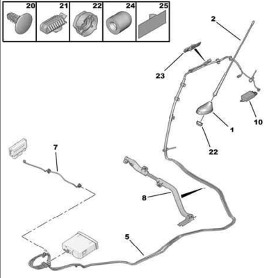

Both the aerials plug into the amplifier unit shown as no 10 in the diagram - but hard to say what's going on inside the unit without taking it apart. You may also have the screen-printed aerial on the rear window too.
The circuit diagram shows 8406 as the electrified aerial connection, with 8404 as just 'aerial'.
