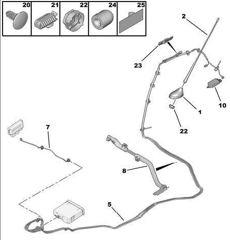

Re: C5 X7 2-in-1 navigation tutorial
Both the aerials plug into the amplifier unit shown as no 10 in the diagram - but hard to say what's going on inside the unit without taking it apart. You may also have the screen-printed aerial on the rear window too.
The circuit diagram shows 8406 as the electrified aerial connection, with 8404 as just 'aerial'.
Yes I have both aerials in the rear window. They're connected to 2 amplifiers (FM1 and FM2). I'm not sure but i think that these amplifiers is only connented with radio by fakra cables, so I think both plugs in my unit (grey and white) have to give the power. I've checked them by straight voltage electrical test screwdriver and there is no power on both. So I hope this amplifier stuff can help me to solve problem with poor FM signal.
