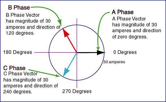

Beaten to it by Simon again, heres my version.
Simon are you an Engineer? You definitely have a good knowledge of this stuff.
Yes you've got it but the words you are using aren't quite right.
They do use it at the same time but are out of time with each other so when the currents are added together they add up to approximately zero.
On an unbalanced load they add up to approximately the imbalance which will always be smaller than the individual loads.
Heres 2 diagrams that make it far easier to understand..
As you can see in the first diagram unequal 3 phase loads as you described use a shared neutral and barely put any current through it compared to the phases
If they were all maximum, say 100amps, there would be no current in the neutral in theory but as it's 1ph loads there would be a little as they don't balance perfectly.
