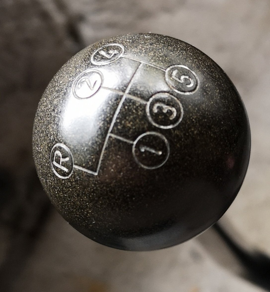

The main thing is the Gearbox, the selector is so bad i think describing it as vague would not be doing it justice, gears are selected by thrusting the lever swiftly but gently in the correct direction to use the momentum of the mechanism to find the required gear, you can feel no gate as such but then the whole linkage set is worn horrifically and required re bushing.
if i remember correctly the Merc had 1st on a dogleg (racing gearbox?) but was a very low ratio which made getting off the line a bit of a scramble.

The Merc is noisy by modern standards. You can't ignore the fact that the cylinder head is immediately to the left of your left knee, and the gearboxes whistle in fifth.
You remember correctly...
Lovely change in this in that sort of precision engineered in as far as commercial vehicles could be at the time way. First is as you say quite low geared, as is second. So you're generally in third by the time you're half way around a roundabout.

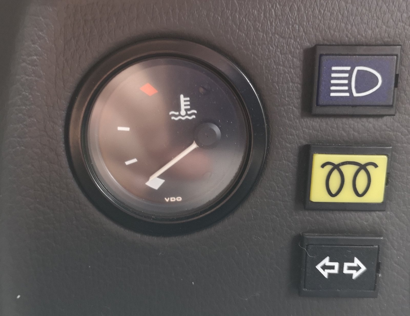

We seem to have a similarly afflicted thermostat however...this is the highest I ever see on mine currently.
I do have a new stat on hand though, just need to get around to fitting it.

The needle on the temp gauge should sit just above the first white line if my memory is correct, i used to love the odments tray on top of the engine cover............in fact, i still have a temperature guage out of that Merc somewhere, i know i saw it recently, the cab of the merc is rather well put together, the Talbot..............Meh.
