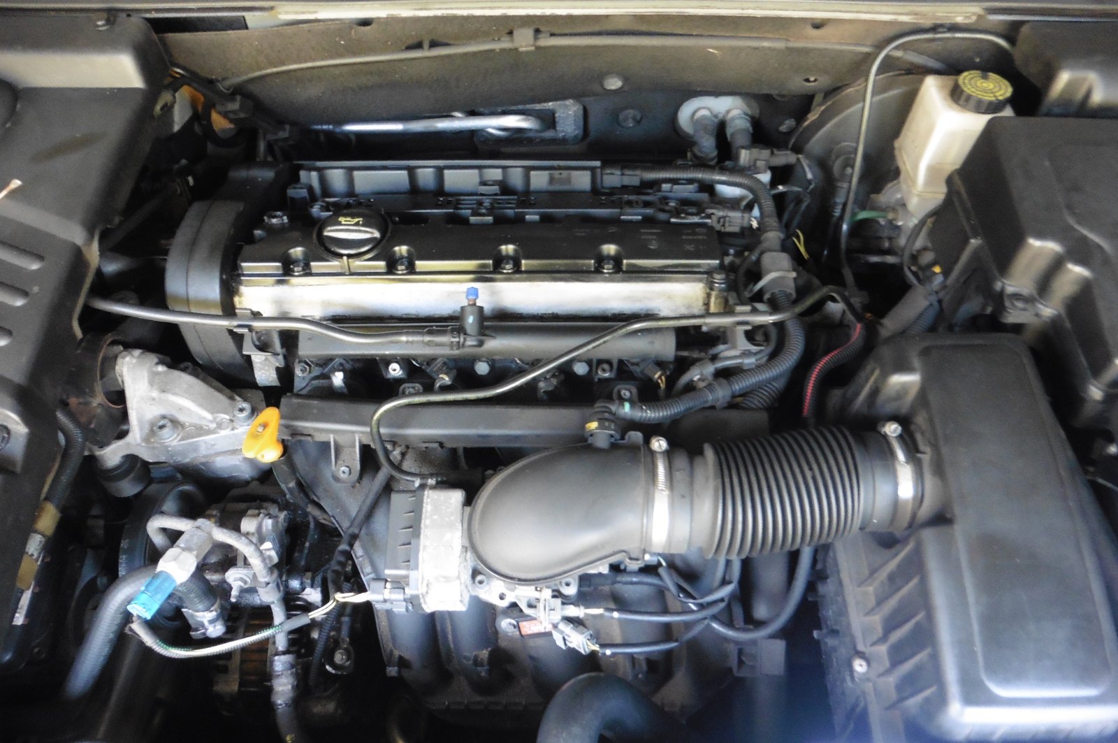

I wonder if someone can assist, we recently purchased a 2003 C5 petrol 1997 automatic estate.
I have added a picture of the engine.
The oil dipstick may have the original top, but the shaft is a length of clear plastic with no markings on it.
The end is touching the oil .
Would any of you gentlemen with the same engine in the photo, be kind enough to measure the length of the oil dipstick to the max and the min markings.

Had enough of that satellite malarkey then? Can't help with your problem here though. For the benefit of others who might be able to help I presume that your petrol engine is the ordinary one not the ferociously unreliable HPi variant (maybe that was never paired with auto box though).
Good luck.
EDIT
The photo has just shown up and I can see that it's not the HPi engine so forget what I said above except for the Good Luck wishes!

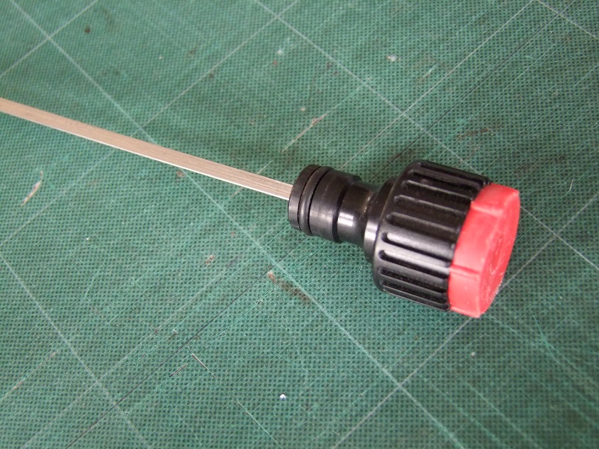

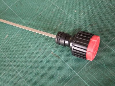

Dipstick repair
Having had the yellow top of a dipstick split and crumble, a repair was effected by using a standard Hozelock-type 1/2" connector. Remains of the yellow top cut off, and the new cap secured to the top of the dipstick with a bit of rubber sleeving and adhesive. Upper end of the steel strip bent over by 3mm to provide positive anchorage.
The snout of the connector was turned down slightly to fit the dipstick tube, and the O-ring retained to provide a seal. The threaded top was blanked with a 1/2" BSP screw-in (red) cap.
Maybe not original, but tidy enough. Distance to the High/Low markings was preserved.
