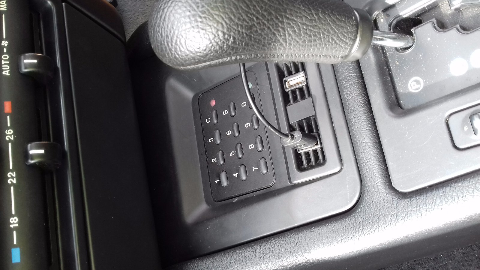

I fitted the usb kit to the xantia and it works a treat. It will be sometime before I get to Wales to print a nice, factory look, retaining insert.
It's powered by splicing into the cigarette lighter wires. I moved the fuse as well so they are on switched live.
The unit is compact and has been stuck to a convenient piece of plastic.
The usb leads were more than long enough but the power leads were much to short and have been extended approximately x3.
I'm very happy with it at the moment, as long as it is reliable it's exactly what I wanted.

James, those USB sockets look excellent and a top job you've done there
Looks OE!!

It's not quite there as the usb sockets have to be removable by going downwards.
They are well wedged in but I can see that being a problem long term.
I'll fully cut out the coin slots later and make a 2 piece insert for each side so they are secure but not under pressure.
In the meantime I just have to be careful not to push down too hard on them or they will dissappear into the center console.

That position ?, the wires out would get in the way for me.....

Oh yeah you are manual.
It wouldn't work for me either if I were.
Could easily move them to anywhere on the center console or the ashtray.

Time to hold up hand to being klutz of the class, but there's something that's always puzzled me about USB ports: my devices that have USB plugs came with chargers (or work with universal ones) that plug into the cigar lighter, or power socket. If I plug a device into an on-board USB port (or, say, one on my PC), i.e. doing away with the charger, will someone explain (hopefully, in terms I'll understand) how (indeed, why) it still works.

van ordinaire wrote: 29 Jul 2017, 21:41 Time to hold up hand to being klutz of the class, but there's something that's always puzzled me about USB ports: my devices that have USB plugs came with chargers (or work with universal ones) that plug into the cigar lighter, or power socket. If I plug a device into an on-board USB port (or, say, one on my PC), i.e. doing away with the charger, will someone explain (hopefully, in terms I'll understand) how (indeed, why) it still works.
Usb is a 2 way data cable with a 5v power supply built in.
The cigar lighter chargers just change the cars 12v to 5v and omit the data pins.
A usb socket just has power at 5v and, if its a radio or pc connection, the data pins as well.
