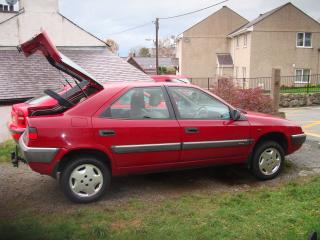

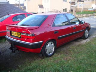

Back On the 18/10/14 I bought myself a nice old Xantia from a young lad in Liverpool.
He was off to uni and needed to free up the funds.
My vans kingpins, amongst other things, had failed the MOT despite the repairs being simple and cheap I did not have time to do them and get to work.
So having seen these pictures on Gumtree I went over to have a look.
It was on just over 103k and had only done 800miles over the last 12 months.
It has full service history in that everything ever done to the car is written in the log book.
Up until the end of 2000 the book is stamped by a dealer, after that the work is just written down.
The little notebook is a diary of how much fuel was put in, on which date and what the mileage was.
There is a running tally of MPG and also weather the car was towing or not covering 17 years.

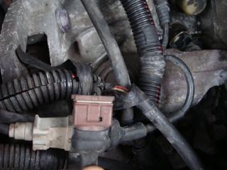

Up Until the 26th the Xantia mostly just sat on the drive. The van was still legal so other than looking over the Xantia not a lot happened. On the 27th I sold my welder and scrapped the van, freeing up the funds to Tax and Insure the Xantia. I also bought a thermostat and 2 spare seals for £12.47 and chucked in a bottle of redex. The thermostat went straight in, I was surprised but the housing was immaculate inside and all the nasty crystals and corrosion were on the outside only.

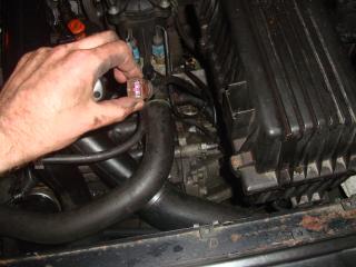

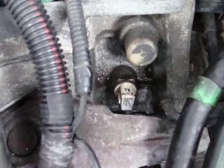

The rev counter was dead so I removed the sensor. It had been inserted too far and the end was ground off. I took the one from the Peugeot and fitted it. The rev counter did come back to life but misreads terribly. I think I need to put the sensor in another 1/2mm or so, I was a bit cautious because of the state of the old one.

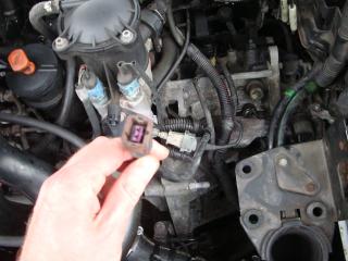

Whilst doing this I found this unplugged brown clip which still hasn't been returned to it's home.

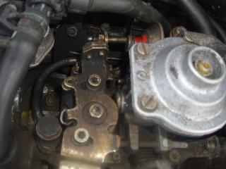

I had a good play with the turbo as well. Starting by disconnecting the arm from the waste gate actuator and trying it in all positions. It made no difference. I couldn't get to the clip to take the air pipe off and spin the turbo by hand so I removed the one from my scrap 306 only to find its impeller severely damaged. I decideded to put a new impeller and service kit on it but that didn't help now so I hit the Xantias turbo a bit with a small hammer. It has started to make a quiet spooling up noise since then but not really given much boost except on the first drive after the where it went well.
That was all I had time for before my next stint of work. So on the 28th it was taxed and insured and I drove it to work and back from 29/10 to 1/11. It behaved ok other than the rear suspension not existing and the brakes being rubbish. I lumped the nsf front wheel into a kerb in the carpark on day 1 so the tyre was destroyed. Thats how it's ended up with 14s, from the 306, on the front for now. I sourced rear spheres on my work days to fit in the days off but no other progress was made. I also now noticed that the heater matrix was a little leaky and bunged in some radweld stuff. Don't like it but matrix can come out in Summer, theres no way thats a Winter job for me.

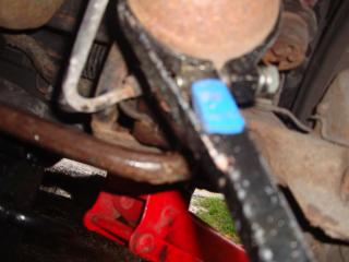

I then had to fit the rear spheres. I wasn't too happy with the spheres as I ordered 4 but only 3 turned up. I am missing the Hydractive centre sphere, which is currently on order. They weren't to hard to fit really, I always thought of them as a bit like changing light bulbs.

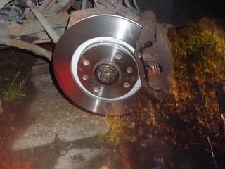

Once I finished fiddling with the pump I fitted some new front brakes. The old ones were half worn on 3 pads but the N/S outside pad was down to 1mm. I fitted new discs because of this, for the price of them it's hardly worth taking the thickness out of the old ones to match the overwork side. I will measure them up and maybe spin them down if a decent amount of tolerance will be left on them for when the new ones are worn out.
Image Image Image
It got dark before I finished that so limited pictures. I bled the front brakes as well, will bleed whole system tomorrow as originally intended Once I did the brakes I replaced the bulb in the boot, which still doesn't work. Slightly annoying and will get fixed tomorrow with the reversing lights.

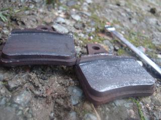

Day 4 5/11
Got the rear brake pads changed and the brakes bled.
Didn't get much else done, the centre sphere arrived at 16.00 and I had finished with the car so it had to wait.
The rear callipers are suffering from the corrosion problem.
It will be addressed later when the majority of the work on the car is done along with new rear disks.

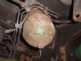

Firstly changed centre sphere, camera ran out of power so only got a picture of the old one.
Was an ok job to do, just have to remove the spare wheel tray for access.
Much easier than the anti sink sphere.

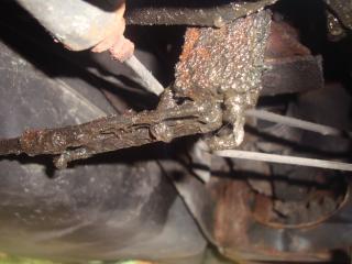

While I was down there I noticed that I don't like the condition of the rear height corrector linkage.
I will be looking into that shortly, the car rides low at the back too so that can be addressed at the same time.

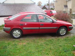

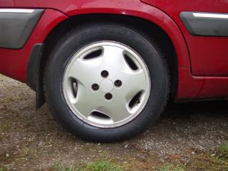

Got my new tyres today.
Finally all four corners on the same size wheel and tyre!
The fitting place scuffed up one of the wheels really well though.
Heres some pictures of the side they didn't hurt.
Image Image Image

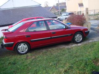

20/11 Day 3
Here we are looking nice and clean.
Interior is sparkling, windows and trim aren't too bad and bodywork is not great.
Couple more weeks and it'll be gleaming.
I accidentally ordered the spheres for tomorrow not today so I'm off out to play now and the rest is getting done tomorrow.
ImageImage Image
The caravan club badge is going tomorrow as well, I'm not a member.

I also had a chance to get the rev counter working properly. Just a case of wiggling the sensor in a bit further and it's all working fine now.
The last little niggles I need to fix are that brown lead, I had a good look today and cannot find where it should be plugged in still. It's a brown 2 pin, pink inside and the wires to it are red and black.

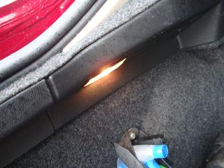

The other thing annoying me is that the boot light won't work even with a new bulb, I'll probably look at that in a minute. Finally the passenger mirror doesn't remember the 2nd setting for reverse gear. I'm hoping thats fixed now, will look in a moment. Oh I managed to take off that caravan club badge too.

In the boot lid, under the plastic trim, is a white component with two wires going to it. This is a simple tilt switch (small ball bearing touching a couple of contacts), and this is what triggers the boot light.

Elma, you might find that brown plug is a spare one that's never been connected! Quite often the Xantia loom contains spare bits for options and slightly different engines..
Does the interior of the plug look like it's been recently connected or does it look well aged and like it's always been disconnected? If so then it's a spare!
James is more than likely bang on the money with the boot light problem... Again, link it out to test.
If the boot light still fails then you'll have a broken wire in one of the concertinas by the hinges...

CitroJim wrote:If the boot light still fails then you'll have a broken wire in one of the concertinas by the hinges...
And then you will start swearing, as there is VERY little room to work, and repair wiring. The best trick would be to train pet rats in the art of soldering!

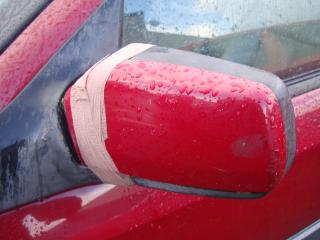

Also to test if my mirror tilts.

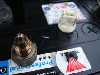

Got the boot light working. It was the bearing sensor switch. I could only get it working intermittently so swapped it with the one from the 306 which works reliably.
Image Image Image
The brown connector does look overly clean inside. I expect it is a blank, I will try to find a blanking plug on the peugeot and secure it out of the way as I find it annoying how it is.

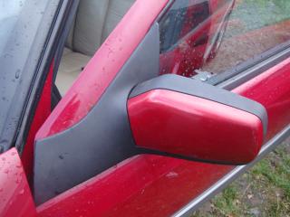

Unfortunately my mirror doesn't hold a second setting for reverse gear, it's not important at the minute I'll investigate later.
Thanks for advice re switch and connector, saved a lot of my time.
