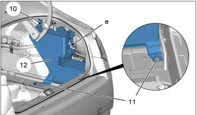

1. Whereabouts is the optional extra amplifier mounted in the C5? Ideally I'd like to hide it away if possible.

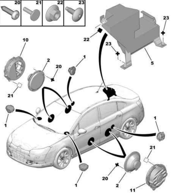

3. Are C5 X7 speakers 6.5" or 165mm as the Citroen service website suggests?

On the Tourer it was located in the rear side wall panel of the loading area. On the saloon it was located in the passenger glovebox, next to the cooling inlet for the Air conditioning (round black vent cap that can be opened or closed).

GiveMeABreak wrote: ↑24 Jul 2017, 16:13 On the Tourer it was located in the rear side wall panel of the loading area. On the saloon it was located in the passenger glovebox, next to the cooling inlet for the Air conditioning (round black vent cap that can be opened or closed).
Is that behind where the sub woofer would be located?
Ideally behind the glovebox would be best, i'm just looking at dimensions, it's 300 x 200 mm, so not exactly small unfortunately . I could perhaps, if I had to, mount it to the underside of the parcel shelf as thats a solid metal surface although that would be a last resort.

EDC5 wrote: ↑24 Jul 2017, 15:52 1. Whereabouts is the optional extra amplifier mounted in the C5? Ideally I'd like to hide it away if possible.

- On the Tourer it was located in the rear side wall panel of the loading area. On the saloon it was located in the passenger glovebox, next to the cooling inlet for the Air conditioning (round black vent cap that can be opened or closed).

As for the Teeter you just unclip it as shown to remove it: - Yes, they are 165mm

EDC5 wrote: ↑24 Jul 2017, 16:24 Is that behind where the sub woofer would be located?
Here's the general locations: Here's a close up of the Sub Woofer - it's mounted in the boot on the right hand side recess as per pic: As long as there is air to cool the amp - you don't want that cooking in the dash area.

I managed to find the first pic of the speaker locations and gleaned the speaker size, good to check that it's correct though.

Re: RD45 questions + Microphone installation C5 X7 + Amplifier installation
That pinouts from a peugeot for sure - some of those models have a retractable multifunction screen in the dash - that may not be there in the C5 wiring as they never had them - or may be missing I wouldn't touch anything there to be honest - how many amps is the amp going to draw? The one in the top picture you posted has 2x20A fuses in it - so that suggests a fair bit?
