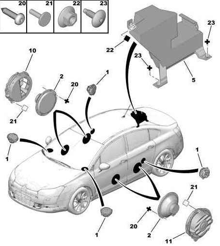

On the Tourer it was located in the rear side wall panel of the loading area. On the saloon it was located in the passenger glovebox, next to the cooling inlet for the Air conditioning (round black vent cap that can be opened or closed).

  1. On the Tourer it was located in the rear side wall panel of the loading area. On the saloon it was located in the passenger glovebox, next to the cooling inlet for the Air conditioning (round black vent cap that can be opened or closed).

Here's the general locations:

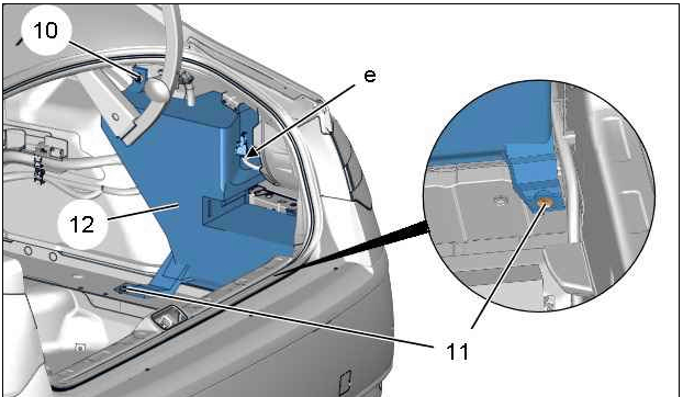

Here's a close up of the Sub Woofer - it's mounted in the boot on the right hand side recess as per pic:
As long as there is air to cool the amp - you don't want that cooking in the dash area.
