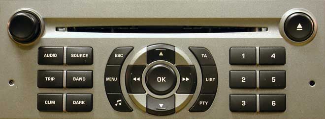

The RT3 I saw in google images are black and oddly shaped. Is there one would match mine, like this?
Again, I really don't need the bigger screen or any telematics (what is that anyway?) but would appreciate BT hands-free for obvious reasons as I never use my phone when driving and it's a PITA having to stop to see who called.

Mike, have a look at the audio and Telematic section of the forum, you will see a picture of the actual RT3 unit that we are talking about for this car. This is like your model but obviously has far more buttons etc with the telephone controls and the Sim card slot.
Again, Mike, your options are a bit limited here, as later Citroen /Peugeot audio head units are not compatible in all cases with all the older cars. Although your car is can-can, the architecture in terms of the wiring are not compatible with the newer systems. This is why they are not an option in the configuration section in Diagbox.
In short, putting a complete RT3 system in will require the larger screen , plus some additional wiring, microphone and some other bits and pieces or it will not work. That's why I provided some other solutions that others have used as a compromise because of this restriction. Again you have to remember when these cars were on the drawing board back years before they came to production, the technology was nowhere near what it is today as I'm sure you appreciate. The added problem with these type of units in your car and mine when I had it, was that they also control some other functions of the car, and if these were to be replaced with an aftermarket unit you could lose some functionality at the end of the day.

Went to the subforum and saw a pic of what looks like my RD4, sweet! :-D

So here is the RT3 Head Unit - Looks similar to the RD4 but isn't and another showing alongside the display:
This is the RT3 System in the Dash of the C5 MK II also showing the larger colour screen on the Dash:
And finally the RD4:
