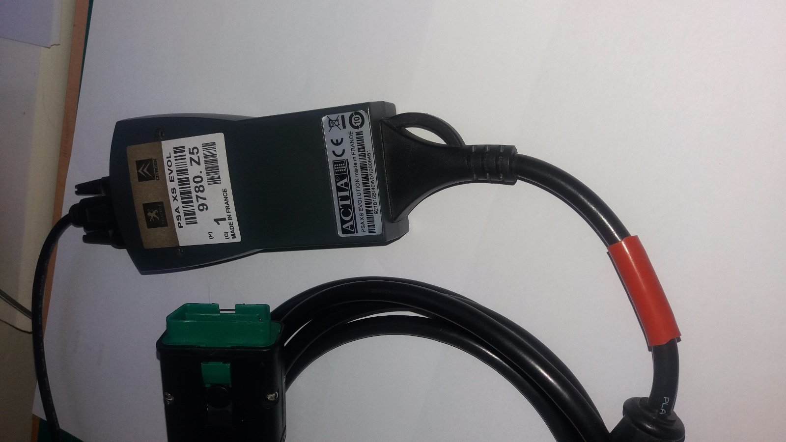

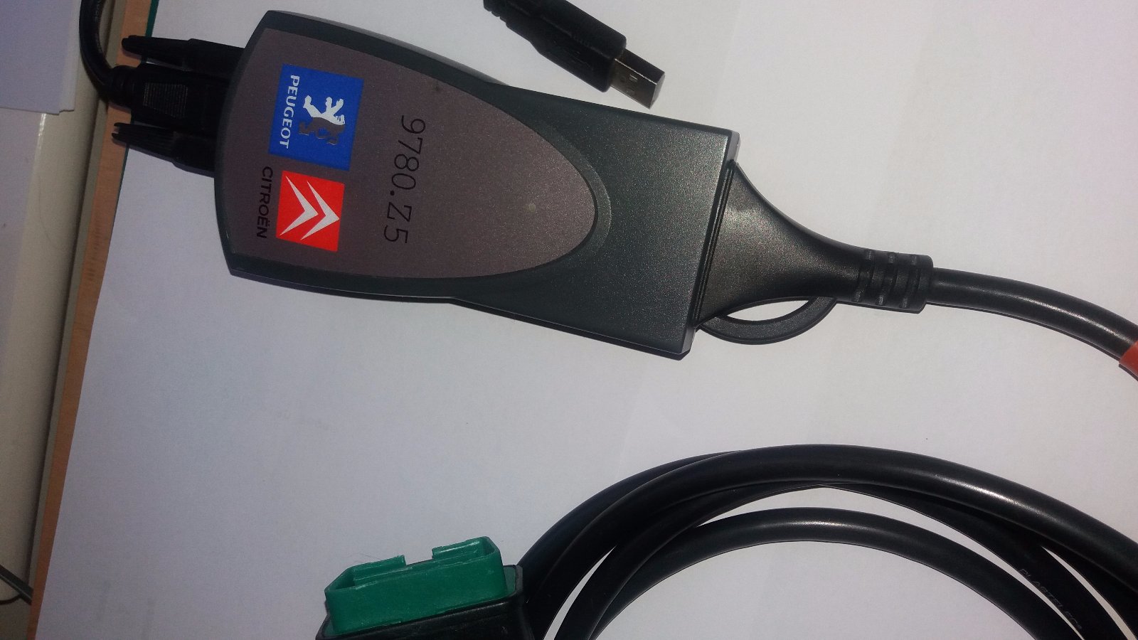

Thanks for replying - I do have a DialogBox as Pics shows but the software is on an old XP computer that I'm having trouble with - a bit hit and miss - and am not very coversant with it - you ask for a Lexia Diagnostic tool - is this better or can my tool be used with the Lexia Software if so can I download it from a site or purchase a disc with it on - or can I get a fresh copy of the DiagBox software...joe

That's the one you need. Used to be called Lexia, but they changed the name of the software to Diagbox; Lexia use from habit!
