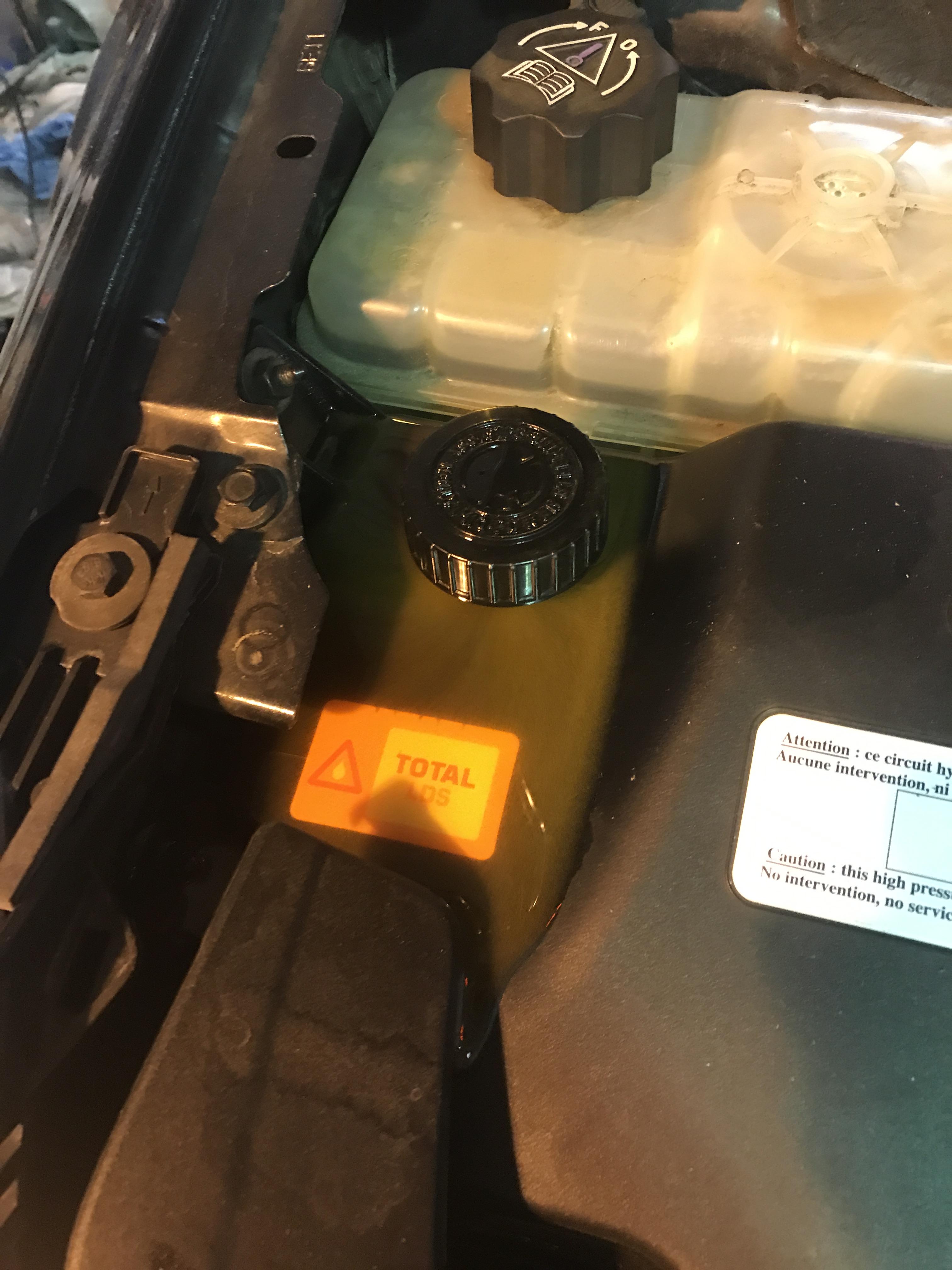

Just a follow up to the possible fault angle....
Whilst I was changing the gearbox oil today something bad happened.
I was lowering the car down from the car lift when I saw this...

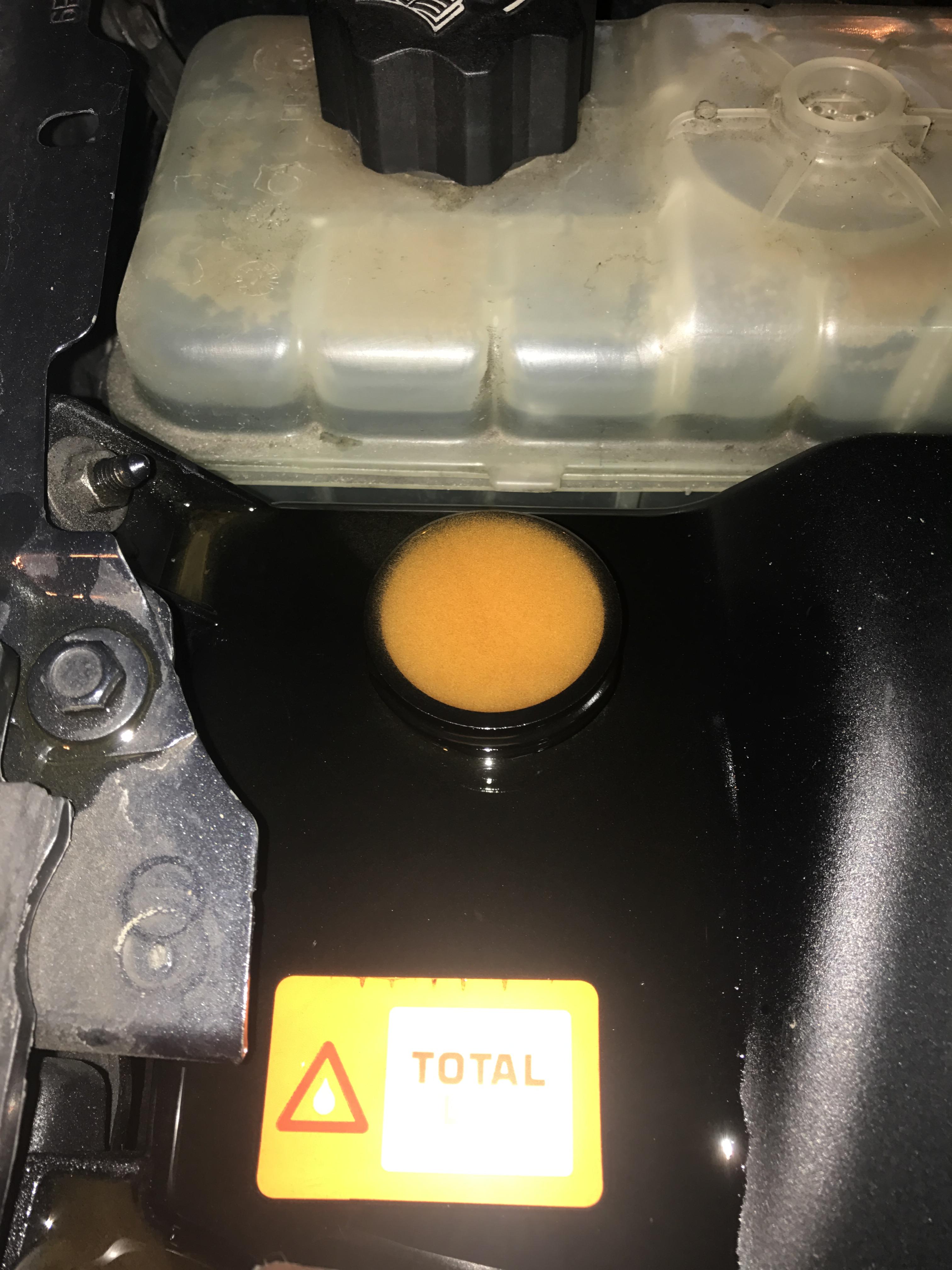

Not good.... It appears to be vastly overfilled... good job I loosened the cap
After it stopped overflowing the tank was full to the brim
I then went on Diagbox and selected the option to "check suspension level"... it then depressurised the system where even more LDS overflowed out onto the floor
After it had finished and the body was literally on the floor I used a sort of douche (
) to suck out the LDS until it was level to the bottom of the filler basket.
I took the car for a drive and the ride seems much softer and more 'magic-carpety'... which is odd as It's only a reservoir.
So.. yeah, I'm guessing the previous owner just filled the tank far too high.... hope no damage has been done, however about a pint of LDS has been lost into the engine bay wall unfortunately.

Mine is too full too, has been since before I bought the car.
Haven't had any problems and keep meaning to fix it.
May even do it one day

There is a known issue in that, if you do not loosen the LDS cap before lifting up a C5 (in a way that suspends the wheels) it can cause issues with the reservoir. Unfortunately Citroen do not make this clear. It is possible that you may now have air in the system.

Hell Razor5543 wrote: 21 Jul 2017, 21:06 There is a known issue in that, if you do not loosen the LDS cap before lifting up a C5 (in a way that suspends the wheels) it can cause issues with the reservoir. Unfortunately Citroen do not make this clear. It is possible that you may now have air in the system.
Luckily I'd remembered to loosen the cap before lifting, upon lowering the car back to ground it decided to lower itself to it's lowest setting (by that I mean retract the suspension rams).. thats when the fluid started pouring out.

myglaren wrote: 21 Jul 2017, 21:05 Mine is too full too, has been since before I bought the car.
May even do it one day![]()
Haha... I'm sure it'll be fine as long as you don't depressurise the system with the cap securely on!

When I had the front tyres on my C5 replaced I had already removed the cover, and before they jacked her up I raised her to full height and loosened the cap. The tyre fitter looked a bit amused, but when they fitted the wheels and lowered her back down she remained at full height (the fitter said that normally they had seen C5s drop all of the way down). He said he would try to remember that trick in the future for when they did other C5s.

Hmm that’s interesting I'll let any garage know in future if they will be lifting the car.
From the sounds of it I think lowering them down can shock the poor little C5 into pissing its LDS back into the tank... and that’s when you know if it's overfilled or not
Does the colour of the LDS look OK? I'm wondering if the previous owner has overfilled it with normal power steering fluid or something
