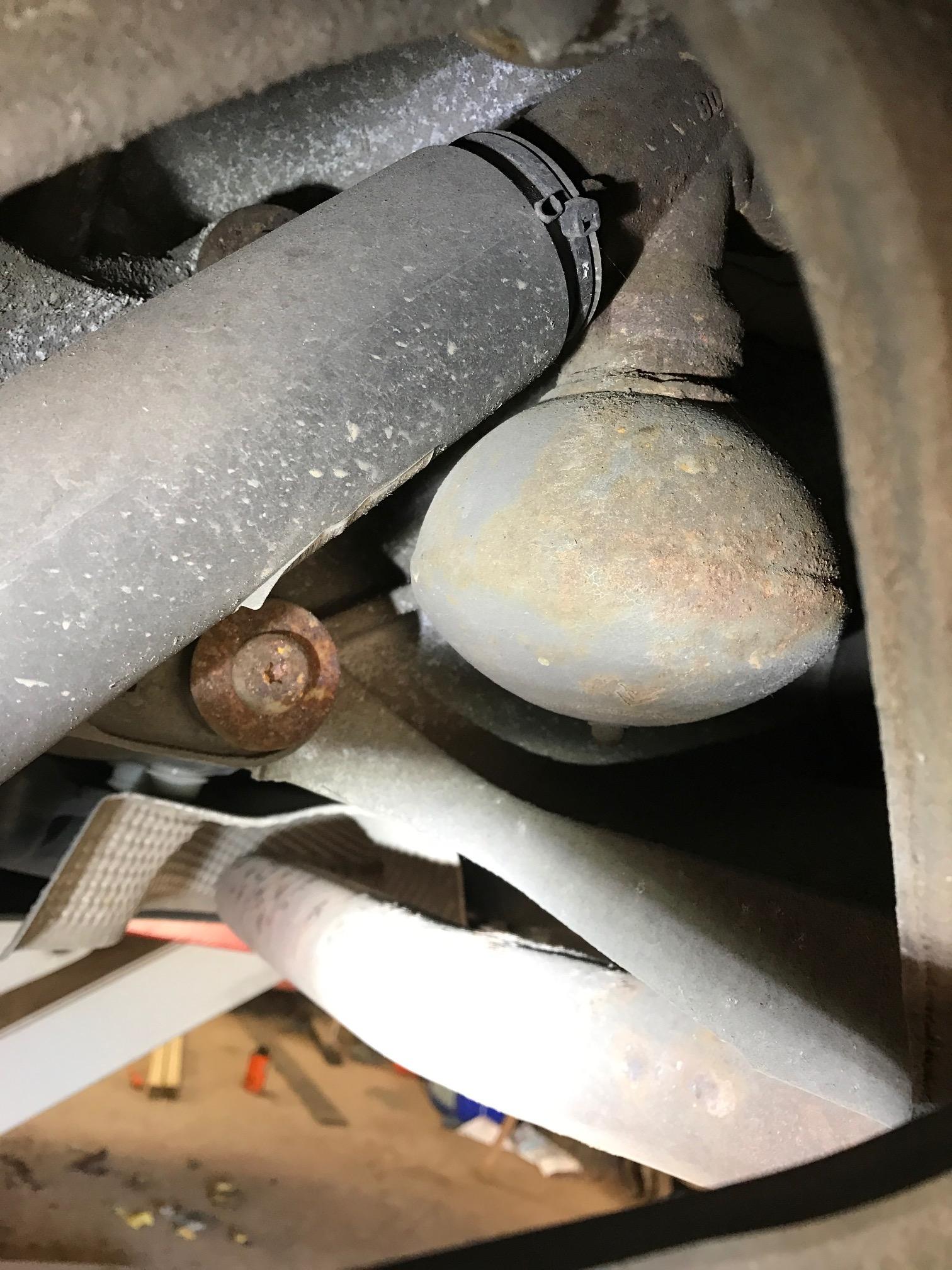

Right then, after lifting the C5 and having a good look around I found a fair bit of corrosion unfortunately.
The corrosion mainly seems focussed on the two rear regulation spheres. Citroen's attempt at shrouds/trays leaves a lot to be desired compared to the ones at the front of the car in my opinion.
The rear spheres seemed ok, with a little surface rust:
Either way, I couldn't read any part numbers but I have no reason to suspect that any of them have been renewed.
Should any anti-rust steps be taken at this point, especially the badly corroded ferrule in the second pic?

Re: C5 X7 Hydractive 3+ Possible Fault
This confirms what I found and the pics I posted.....I cleaned mine all up and heavily coated the parts in dinatrol wax after painting them. Like my car the problem was very localised.
How did you clean them up if you don't mind me asking?, sandpaper / wirewool or something else?
I've got some Waxoyl in the garage that might be suitable to coat the fittings in after I've cleaned the rust off.
Yeah, I'm pleased to see the issue as a local one, specifically the hydractive components. I'm guessing a steel sprung C5 would be spotless underneath.
- Posts: 11836
- Joined: 28 Mar 2013, 21:05
- x 1996
I used a wire brush, strips of carbide paper and rust converter, anything I had at hand to be honest as it did not need to look good........I then painted with dinatrol after zinc painting them....
