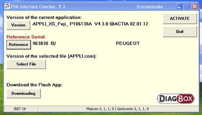

Re: Merged Lexia & Diagbox threads
Many thanks Mike T.
Now what is this telling me? Is that 'B' a problem device?
C4 Grand Picasso 1.6 HDi 16V FAP/DPFS 110, -Auto (DV6 - 80kW) (C4) (DT) (2006-2008)
Toyota Aygo Black 2007 [well almost a french car!]
Xsara Picasso 2.0 Hdi Exclusive 2005
1220 GS Service Van RHD 1973
- x 6948
Yes, that serial no. is blacklisted. You should be able to use it with Diagbox version 5.29 and Lexia and PP2000 though, but you may also need to downgrade your firmware version to 4.2.4 (APPLI 4.2.4DB.COM)
