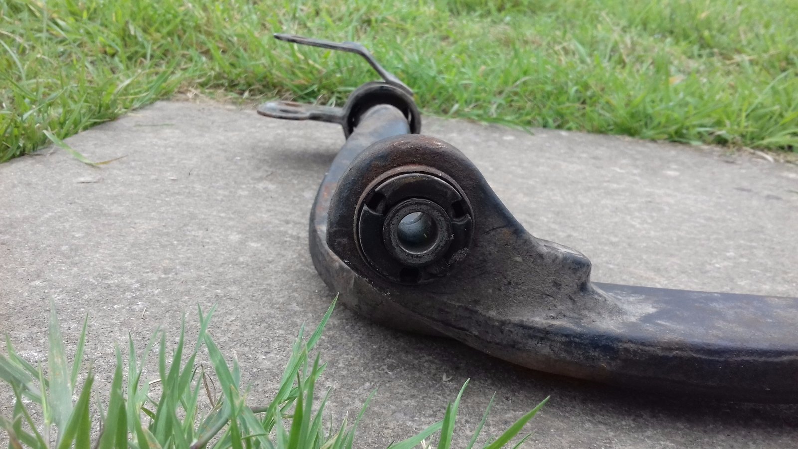

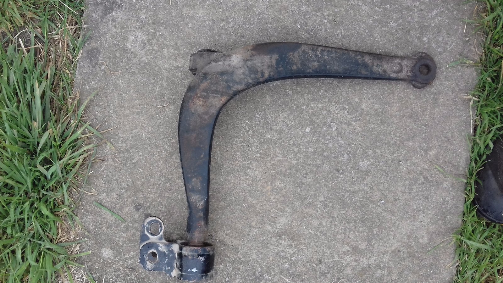

Paul, here's the pictures:
The 'casting flash' is the line you can see on the side of the arm
Hope this helps you to align the bushes Paul...

Re: Xantia P bush fitting
If it helps further heres an os arm with fairly new bushes.
My p bush is a little off. The flange sits parrallel to the ground both ways up when fitted correctly.
