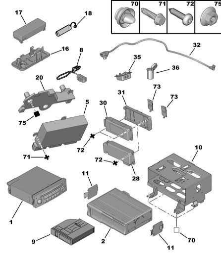

So I've had a look and from the diagram below (you won't have all these items) I can confirm that you don't have the MDS Services Module. What you do have according to the specs for your car are the following items:
1 - "RD4/MP3" RDS Compact Disc Audio System
8 - Radio Telephone Microphone (Independent Telematic Unit)
16 - Tel Interface Unit Support (Independent Telematic Unit)
17 - Independent Telematic Unit / Stolen Vehicle Locating Box
18 - Emergency Call Battery (Contained Within The Telematic Unit)
35 - Video Peripheral Connector (Glove Box)
I'm Assuming that in the glove box you have only the RCA sockets for Video / Audio in and not a SIM Card slot? Can you confirm that you don't have the Citroen Chevron and the red SOS buttons on the Central Console?
As we know the standard RD4 / MP3 unit you have is not bluetooth enabled and you don't have navigation, I can't really say what the Telematic Unit actually does in this case.
Anyway, if you have one, it is located behind and above the small dashboard monochrome display (that you have now removed from your pics) A small rectangular box (item 17).

To answer your question, pins 3 & 9 would seem to be the ones.
The Microphone (8482) has 2 wires:-
Wire 8487 is the telephone hands-free input + signal
Wire 8488 is the Telephone microphone earth input
8480 is the Audio Unit, so you can trace where these are supposed to come back to the unit
8V NR = 8 Pin Black Connector
10V NR = 10 Pin Black Connector
12V NR = 12 Pin Black Connector
12V NA = Another 12 Pin Connector (plug Colour unknown or Not Applicable - probably inside the Quad Lock)

Do you have a diagram of the loom to show where the Mic cable finishes up on the cars without telematics?
Although it is looking like I'll have to run my own cable tbh
