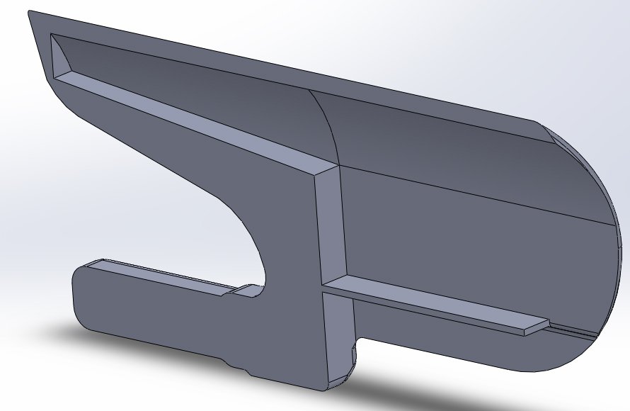

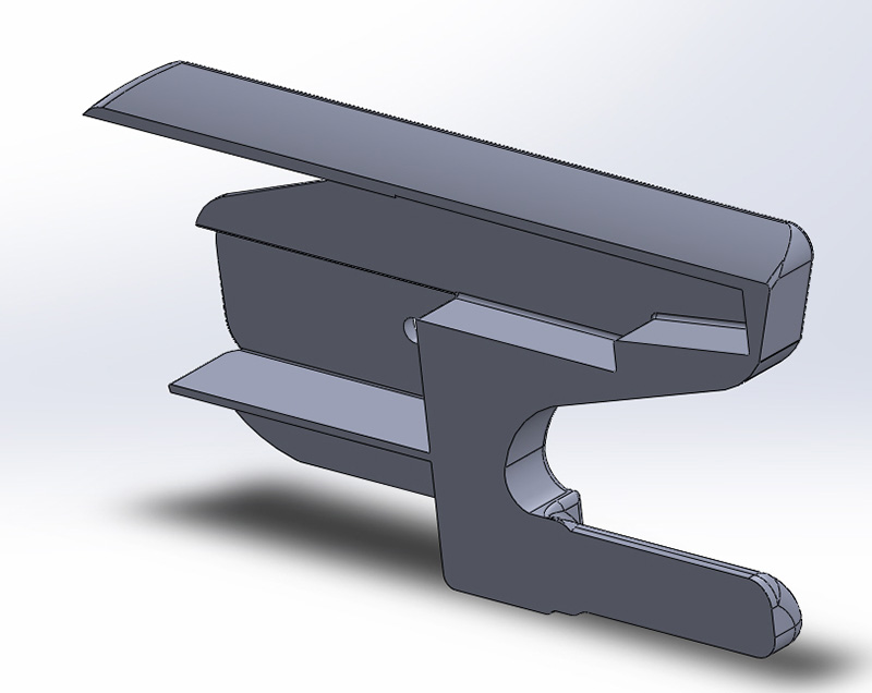

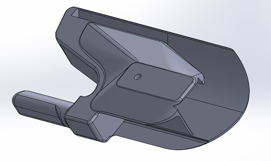

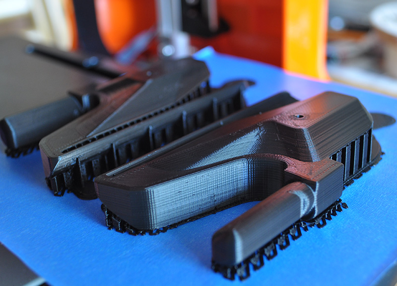

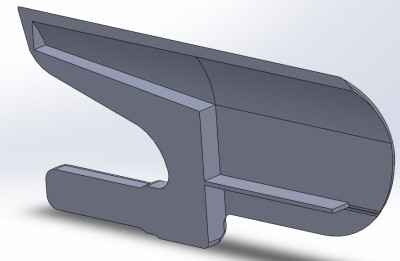

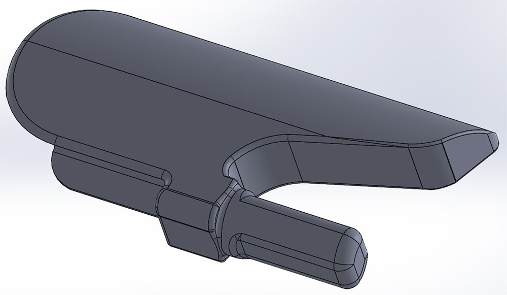

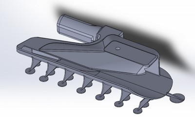

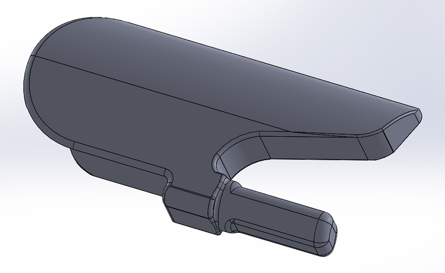

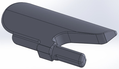

There was request from mate of mine if there is any chance to be made something about broken hooks for that trunk blind / cover. One option is 54e for set from Citroen or.. 3D printed new ones.

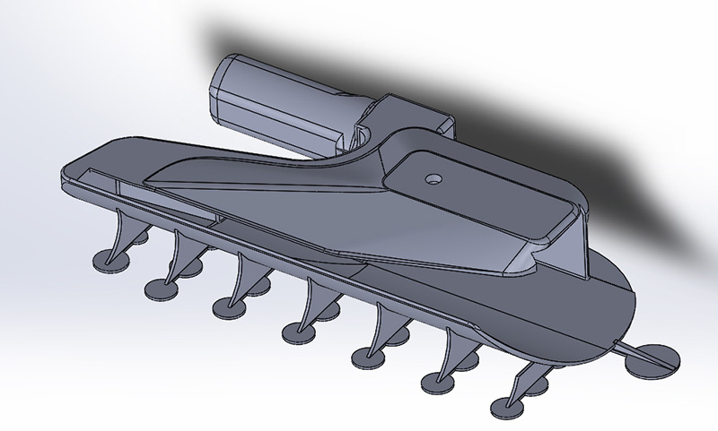

I spent some time measuring, modelling and test so here is some result that is kind`a OK for use / print.
Here are ready 3d STL files :
[The extension zip has been deactivated and can no longer be displayed.]
and in case you wish to see them as 3D object use that site: http://www.viewstl.com/
post notes:

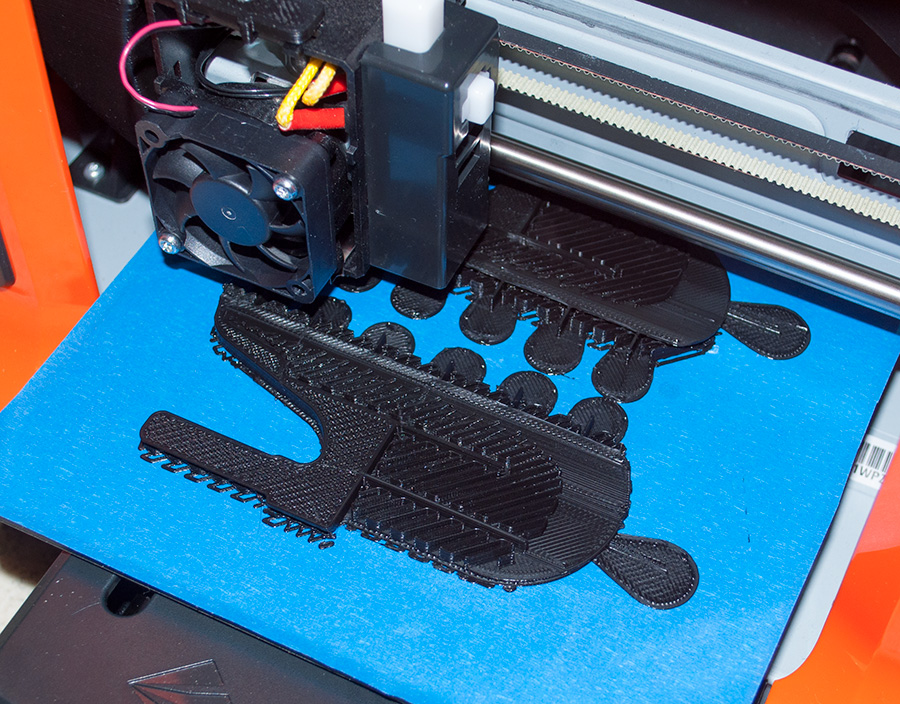

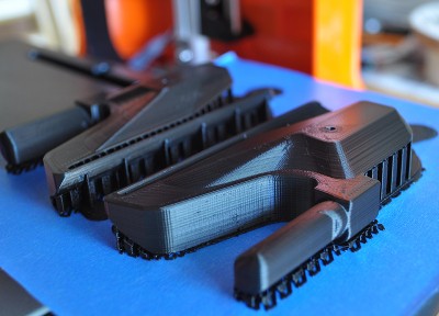

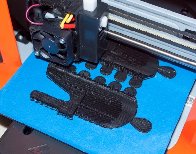

There are 2 set of files. One is "clean" and is your choice how to print it, the other help my printer. I mean that with the "helper claws" give me good result on PLA print on cold bed. My first attempts even with OEM printer software helpers end as that:
Hope that will help someone else also :)

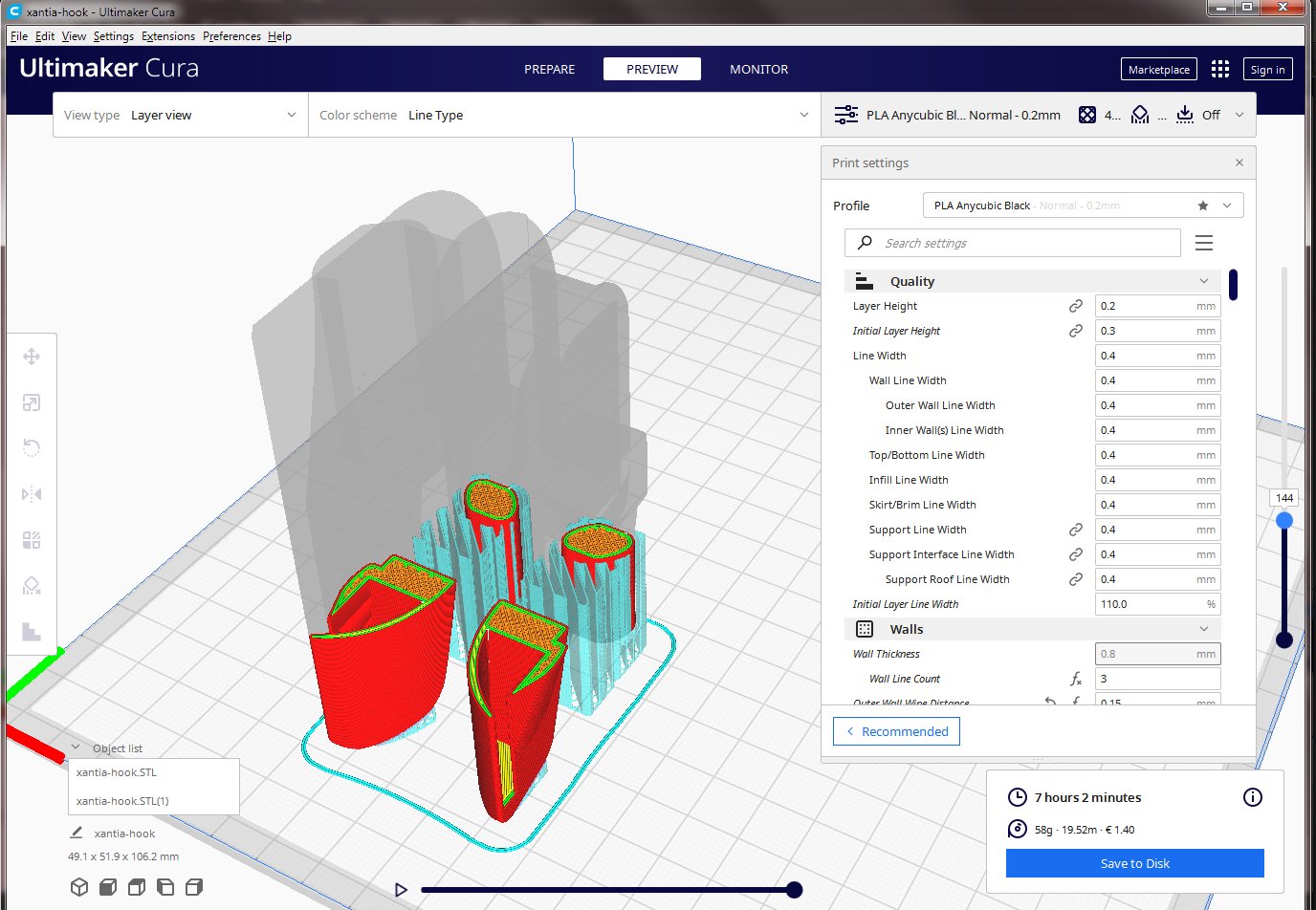

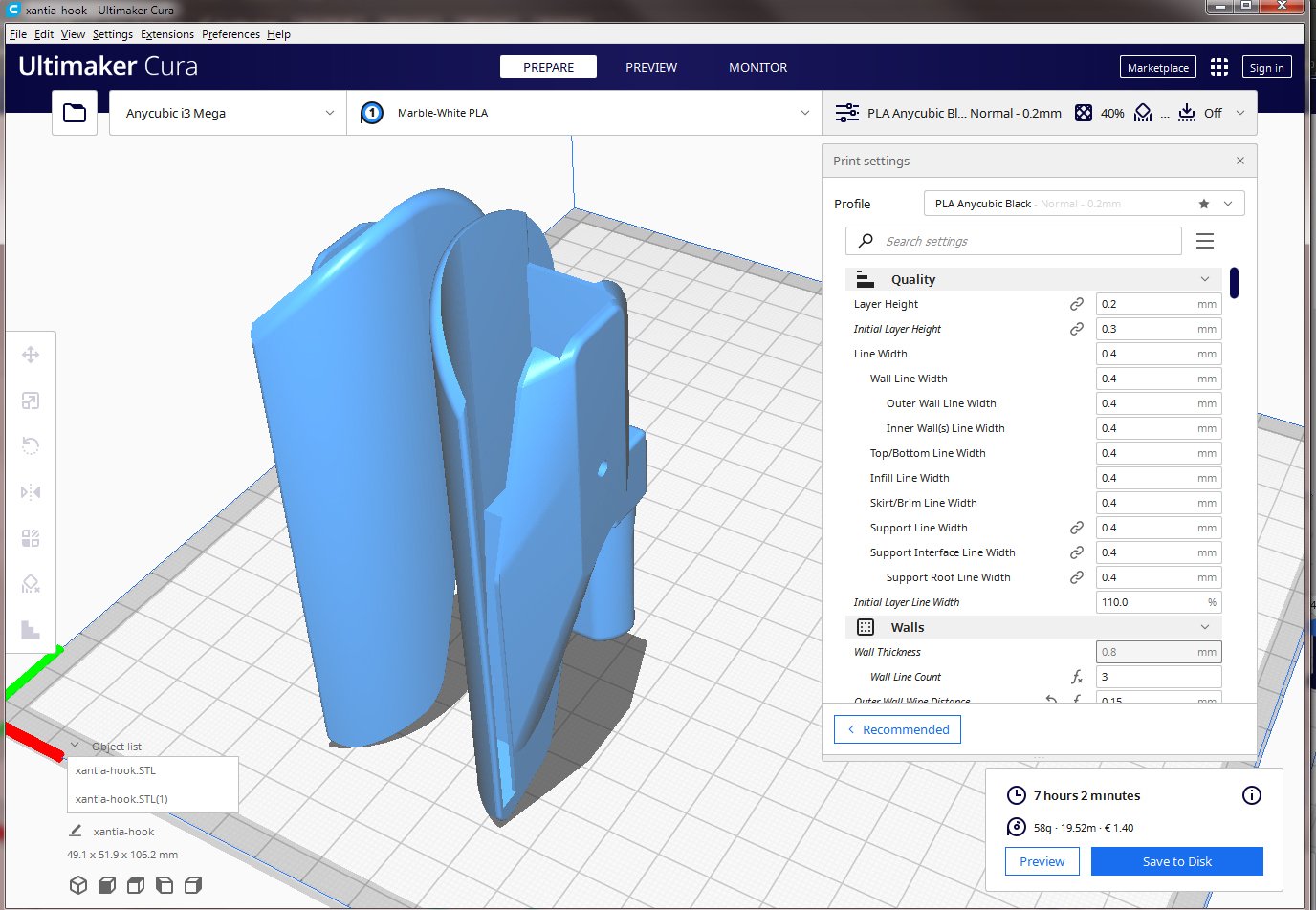

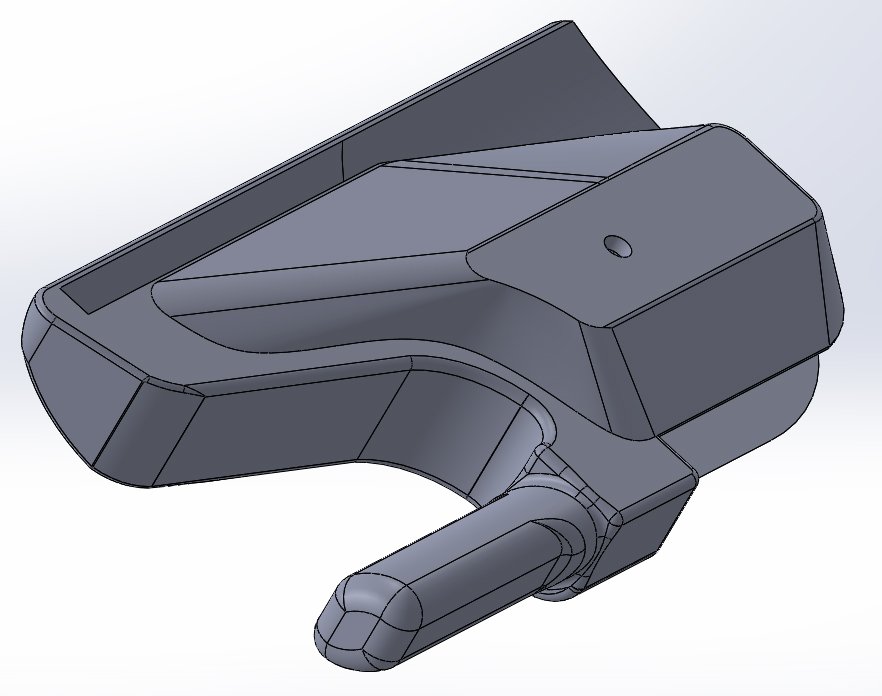

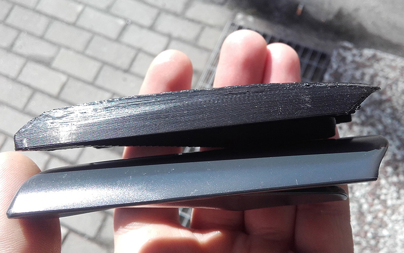

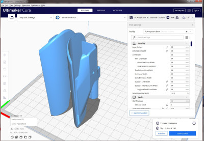

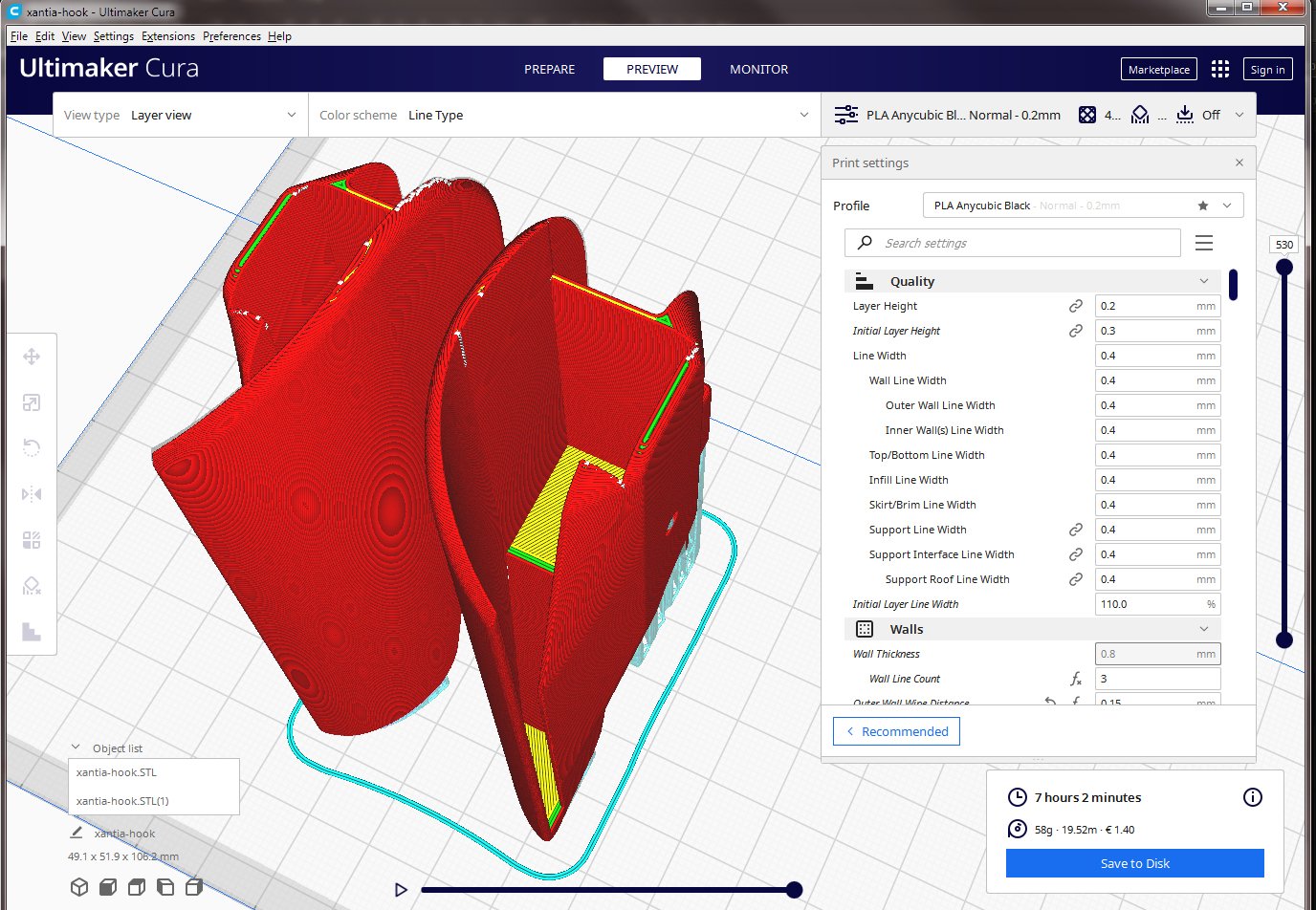

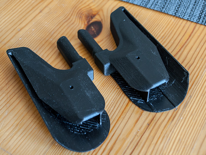

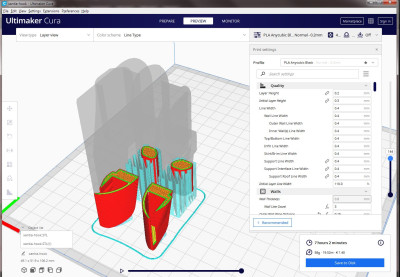

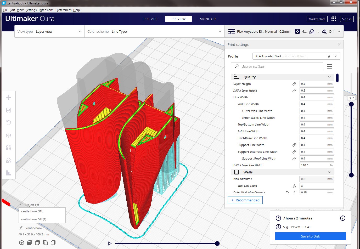

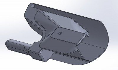

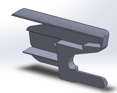

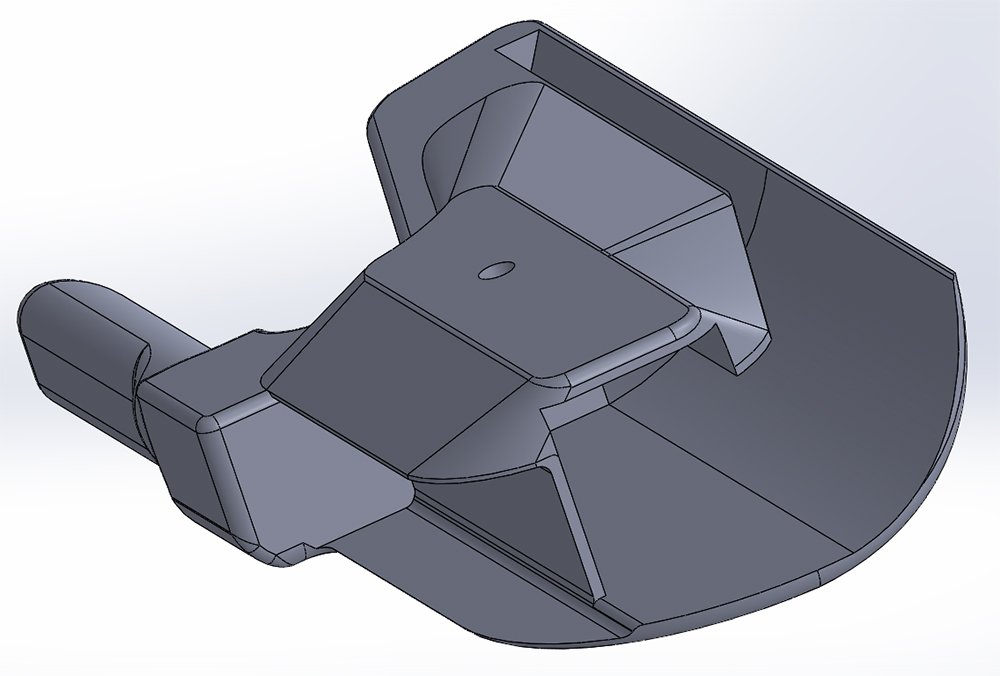

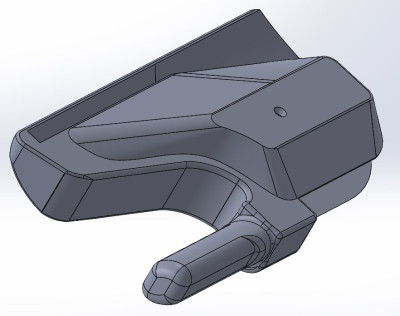

As time passed, I have to 3D print another set of that hooks, so I rework the file:
Now is with better design and easy or say proper for 3D print. As you can see from my screenshots, the vertical print come the clean one. Or in case you have access to 3D printer with PVA (water dissolving filament) , then better print it horizontally. My settings was 0.2mm per layer , 0.3mm initial layer, coolant from 3th layer, and wall count -> 3 , infill 25-35%
In some part of the topic was question for the option to 3D print some break guards or something as that. There are already industrial 3D printers that can produce parts from metal but will cost quite a lot.
The next option is to 3D print the part, and use it as mold core. Then when the material dry, you burn the plastic and pour the metal in it.. Still, quite rough to do it at home kitchen or garage... :-D
