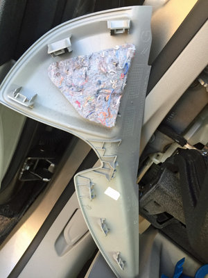

1) To make access easier, you will need to remove the dashboard trim side panel from the passenger’s side. Very easy - use your trim removal blunt blade tool to carefully prise the edge and it will easily snap away:
The inside of the end dash panel trim once removed.

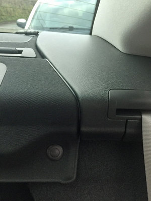

4) Start gently tucking the wiring under the back of the parcel shelf

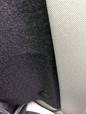

7) Continue wiring under and past the seat belt trim then down and in between the upholstery padding and the boot divider.

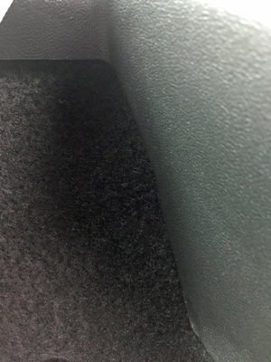

10) Now you can thread the wire under the plastic side panel trim that extends under the seat base cushion area. Picture below shows seat base tilted forward behind front passenger seat. The wiring can now be threaded under the carpet sill trim.
11) Thread the wire under the plastic sill trim.

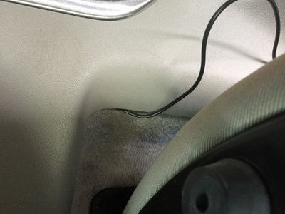

18) Feed the front camera power wire through the side panel recess and along behind the tweeter trim. From there feed both the rear and front camera wires up through the ‘A’ pillar trim cushion.
19) Both wires routed to the side tweeter and up behind the ‘A’ pillar trim.

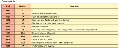

24) Fuse Box A is located above the BSI (note: In a Right Hand Drive, the BSI and passenger fuses are located inside the Passenger Glovebox compartment. In a Left Hand Drive, it is in the same location, but in the Driver’s fold down storage compartment on the left)
List of Upper Fuses in Fusebox ‘A’

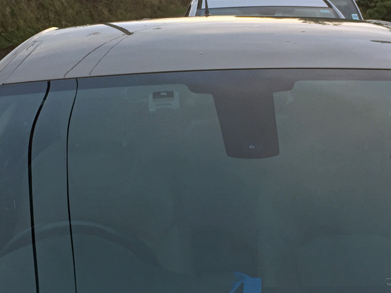

Front view
Not too bad - hardly noticeable next to the rain / sunlight sensor
Close Up
Oops, left the quality control sticker on!

It turns out that all the Passenger compartment 'Fusebox A' fuses are Battery +, so as I found out to my cost, if you forget to turn the camera off - a serious battery drain will occur over a few days! Having consulted the wiring diagrams, even the 30A Front Accessory socket / Cigar Lighter that is supposed to be 'Accessories +' is also permanently live, but is additionally controlled by the BSI - so the feed at the fuse is permanently on, but there is a third wire on the front accessory socket itself that is directly connected to the BSI. So that was hopeless. Finally I managed to find a 10A fuse that controls the Electrochrome Mirrors, Additional Heater Unit (Diesel) and Auto Gearbox (F4). This is the only ignition controlled + there is on the BSI fuse box in the passenger compartment. Connected this up and bingo - the Camera Unit now fires up on engine start and turns off after about 15 seconds when the car is switched off (and it has drained the small residual charge stored in the camera battery).
