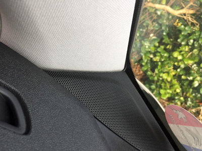

Airbags

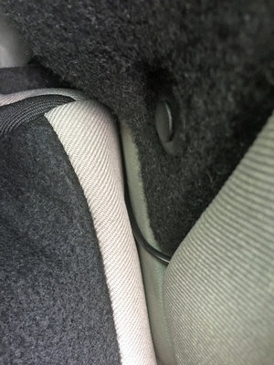

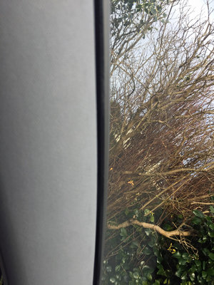

Never wire anything via the side headlining of the car. Many post 2001 cars have curtain airbags that deploy along the length of the passenger cabin. Should this deploy and you have routed a wire underneath the side headlining, it could act as cheese wire and cause a fatal injury. I should add, that the manual for this model actually recommended wiring the rear camera via the side headlining in the manual! I emailed them to advise them of this and they will be pulling the manual and making amendments ASAP - so result there.

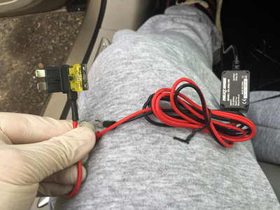

Hard Wiring Kit

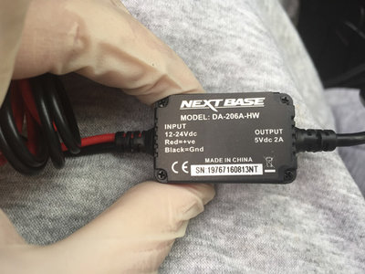

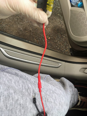

The kit comes with the standard 12V cigarette lighter adapter. This converts the 12/24V supply to 5V which is what many of the Dash cams run on. In my case, as there are 2 cameras and an optional GPS logger that can be purchased, so the adapter allows 2.5 amps to be drawn.
As I did not want any wires dangling about, I decided to purchase a hard wire kit for dash cams. As the Rexing one was not available in the UK presently, I confirmed with Rexing USA that the Nextbase kit via Amazon (also sold in Halfords for £20) would suffice and that allows 2amps to be drawn. The kit comes with a mini USB lead that plugs into the camera at one end and the other end is hard wired into the 12/24v transformer. The transformer then outputs a positive with a barrel connector and a negative ground wire.
Included in the pack are 2 ‘piggy back’ fuse adapters. You get the mini and standard types, so fine for PSA cars. Basically, you locate a suitable switched + fuse (20amp recommended) and extract the fuse from the fusebox in the passenger compartment, plug the fuse into the adapter, next to the 2amp fuse already supplied. You then plug the fuse adapter back into the fuse box where the 20 amp fuse was. This provides the power to the original equipment and also to the dash camera. The ground wire then goes to any suitable earth location.

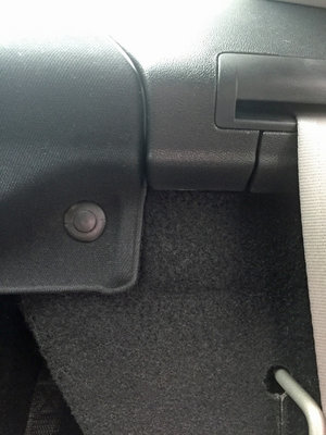

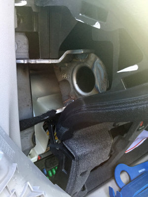

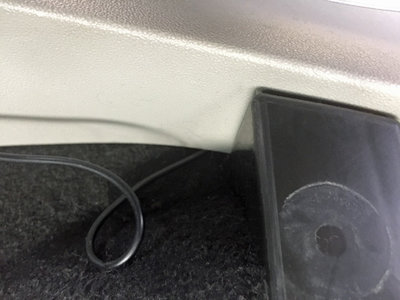

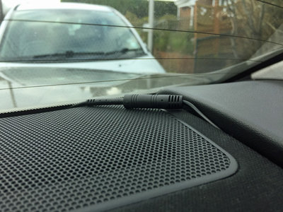

1) To make access easier, you will need to remove the dashboard trim side panel from the passenger’s side. Very easy - use your trim removal blunt blade tool to carefully prise the edge and it will easily snap away: The inside of the end dash panel trim once removed.
This space makes it easier to work with the fuses and to route the cables. 2) Open Glovebox and remove fuse box trim. Rear Camera

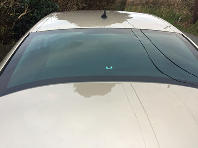

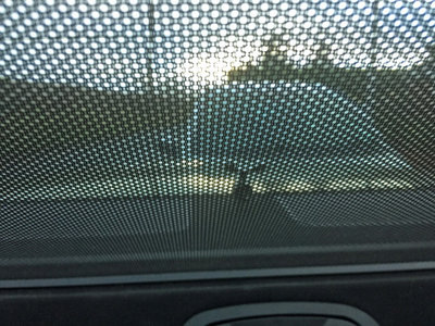

3) Retract rear blind (if raised) and carefully clean rear window of grease / dirt. Roughly position the rear camera, but do not leave any excess wire here as there is just enough to do the job using the floor route. Don’t fix the camera to the screen at this point as you’ll need to fine tune the position with the camera active later on. 4) Start gently tucking the wiring under the back of the parcel shelf 5) Move the front passenger seat forwards to allow working room at the rear. Lower the rear passenger seat, raise the base cushion so that the seat can fully fold down. Continue routing as shown. 6) Route the wire under the trim where the seat belt housing is. 7) Continue wiring under and past the seat belt trim then down and in between the upholstery padding and the boot divider. 8) Continue routing the wire through to the bottom, where the wire should exit. 9) Once the wire is through, raise the rear seat backrest in to the upright position. 10) Now you can thread the wire under the plastic side panel trim that extends under the seat base cushion area. Picture below shows seat base tilted forward behind front passenger seat. The wiring can now be threaded under the carpet sill trim. 11) Thread the wire under the plastic sill trim. 12) Continue tucking the wire under the plastic side trim. 13) When you get to the bump stop for the rear seat base, thread the camera jack under the side trim and gently pull through from the other side of the trim after the bump stop. 14) Continue to tuck the wire in under the plastic side trim through to the front passenger sill side trim. 15) Continue to route through to front compartment under the side trim. 16) Tuck the wire under second sill trim in front passenger compartment, ensuring the wire is relatively taught so will not hang down and interfere with the front passenger seat movement. 17) Route the wire up the front passenger footwell side trim and up to the dashboard side panel area. Be careful of the metal within this area - it has sharp edges in places! 18) Feed the front camera power wire through the side panel recess and along behind the tweeter trim. From there feed both the rear and front camera wires up through the ‘A’ pillar trim cushion. 19) Both wires routed to the side tweeter and up behind the ‘A’ pillar trim. 20) Wires located behind ‘A’ pillar trim - note: there will be a section of the trim (middle to three quarters of the way up) where the wires will not go as far back into the trim. Once past this section they will continue to recess well into the trim. 21) Route the wires around the ‘A’ pillar corner and along the windscreen headlining, through to the roof console unit. 22) Route the wires around the trim using the rounded corners of the trim to gently recess the wires. Be aware that in the middle of the roof console trim, where the main rain sensor moulding merges, the wires will meet some resistance - DO NOT force these into the console, just tuck them in once you have passed this section. There is a ribbon cable behind here that you do not want to damage. 23) Once passed the roof console, continue to tuck under the headlining, leaving the plugs hanging where you have decided to mount the front camera.

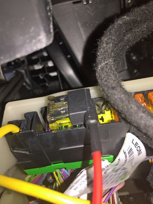

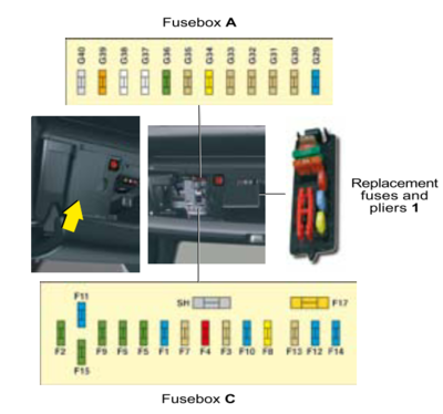

Power Supply Connection

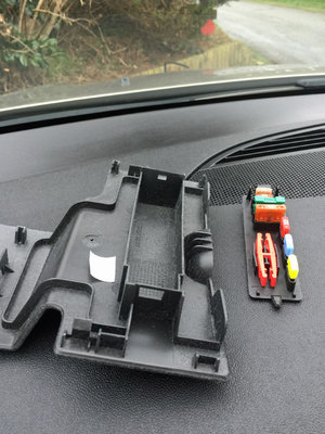

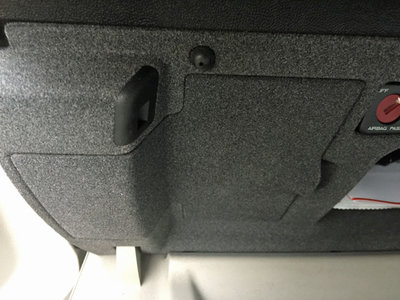

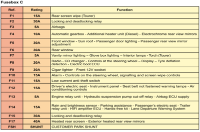

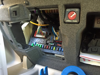

Behind the fuse box cover, there is a compartment which stores spare fuses and the fuse removal tool (although I found that pretty useless as there isn’t really enough room to use that for the upper fuses. I used a pair of thin nosed pliers to extract the fuse. 24) Fuse Box A is located above the BSI (note: In a Right Hand Drive, the BSI and passenger fuses are located inside the Passenger Glovebox compartment. In a Left Hand Drive, it is in the same location, but in the Driver’s fold down storage compartment on the left) List of Upper Fuses in Fusebox ‘A’ List of Lower fuses in Fusebox ‘C’ 25) I've decided to update this based on whether you want a permanent live to the Dash Cam that will stay on until you switch it off at the camera (or your battery dies)! - or a switched live that will turn the camera on or off in line with the car’s ignition. Some people may want to take advantage of Cameras that have an accelerometer - so they turn on when the car is bumped (for example, when in a car park and the car is knocked - or a psycho with a shopping trolley on a mission) - so in this case a permanent live may be needed if your camera does not have a decent battery reserve for this feature.

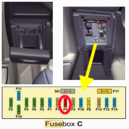

Permanent Live
I needed a 20 Amp fuse, so for the purposes of this guide and if you want a permanent live, you could choose fuse G37 for ‘Heated Front Seats in Fuse Box A.
I did not want to use the lower 20 amp fuse used by the radio and other sensitive equipment, so as to avoid any possible interference on the same circuit (although a Ferrite Core Connector was supplied with my Rexing Camera Kit). I used the pliers to extract the 20 amp fuse.
Note: By very careful NOT to pull or stress any of the BSI connectors or wires. 26) The G37 fuse from Fusebox A uses the standard ATO/C fuses, so I used the large ATO/C adapter from the Nextbase Kit to insert the 20 amp fuse. There is already a 2 amp fuse inserted into the adapter (the brown fuse pictured below) - do not be tempted to pull this out, there is no need and it could be difficult to replace. 27) Using the supplied bullet connector, connect the fuse adapter to the red positive wire from the voltage converter. The voltage Converter unit 28) (a) Now plug the Fuse adapter into the original location of the fuse you extracted. This will supply the original circuit and provide a 2 amp protected circuit for the camera. Note: this picture was taken upside down to show you the connection - this is the upper fuse box. 28) (b)
Switched Live
Choose this option if, like me, you keep forgetting to switch the camera off which causes a car battery drain. There is a 10 Amp fuse (F4) that controls the Electrochrome Mirrors, Additional Heater Unit (Diesel) and Auto Gearbox. This is the only ignition controlled + there is on the BSI fuse box in the passenger compartment on my car.
This takes the slightly smaller fuses - but the Nextbase kit already includes both types. This on the C5 X7 is Fuse number F9 on the lower Fuse Box ‘C’ as shown below:
Be aware that the cigarette lighter (Fuse F9 in Fuse Box ‘C’) is categorised as permanent live, but is controlled by the BSI at the socket end. This will mean that the BSI will switch off the power depending on battery condition (Economy Mode) or 30 minutes - so if you are using the accessories / cigar lighter adapter supplied, be aware of this.

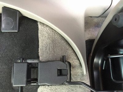

29) Now slightly under the bolt as shown using the 13mm spanner, just enough to allow the forked connector of the black ground wire from the voltage transformer sit behind the washer, then retighten the nut. This provides a good earth. 30) Temporarily connect the camera up to the jacks at the headlining and ensure the unit powers on and that both cameras are working.

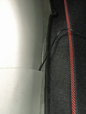

31) Carefully tidy any excess wire, using a few lightly applied cable ties and stow this into the fuse compartment. 32) Replace the Fusebox lid. 33) If all is working, ensure the area of the windscreen glass where the front camera will be attached is clean. Attach the 3M pad to the plastic mount first of all. Then slide the mount into the camera recess and note the fixing position, allowing enough room for the camera to slide upwards when removing from the mount. Remove the other side of the 3M mounting pad and then attach the mount to the screen and hold for several seconds. Leave for a few minutes, before inserting the camera onto the mount. Plug in the camera and switch on.

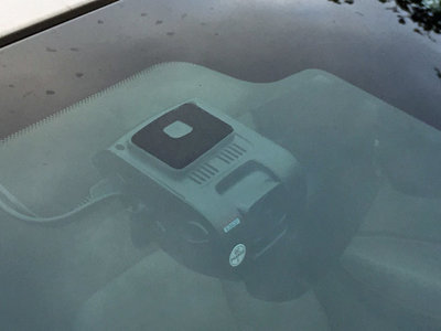

I found that I needed to very gently bend the bracket slightly to obtain the correct angle for the C5 Saloon. I also needed to adjust it a few degrees down on the right side to get a level picture on the camera. I suggest using the long nose pliers and wrapping the metal of the bracket in some cloth, so as not to damage the bracket finish whilst bending the bracket - and be very careful as it is not that strong at the join and may break if over manipulated. I found the position just below the second heater element was ideal.
Check the position by looking into the camera display (or with the assistance of a helper). Remove the backing from the adhesive pad and attach to the mounting bracket first, then when you are happy with the location, attach the other side of the pad to the window. ‘Shields up!’ Rear blind raised. Seeing how this pad is a bit conspicuous, I may well buy another 3M pad that has a black backing and use the bracket to cut out a template to replace this as I’m not keen on how this looks!
Rear View Front view
Not too bad - hardly noticeable next to the rain / sunlight sensor Close Up

It turns out that all the Passenger compartment 'Fusebox A' fuses are Battery +, so as I found out to my cost, if you forget to turn the camera off - a serious battery drain will occur over a few days! Having consulted the wiring diagrams, even the 30A Front Accessory socket / Cigar Lighter that is supposed to be 'Accessories +' is also permanently live, but is additionally controlled by the BSI - so the feed at the fuse is permanently on, but there is a third wire on the front accessory socket itself that is directly connected to the BSI. So that was hopeless. Finally I managed to find a 10A fuse that controls the Electrochrome Mirrors, Additional Heater Unit (Diesel) and Auto Gearbox (F4). This is the only ignition controlled + there is on the BSI fuse box in the passenger compartment. Connected this up and bingo - the Camera Unit now fires up on engine start and turns off after about 15 seconds when the car is switched off (and it has drained the small residual charge stored in the camera battery).
