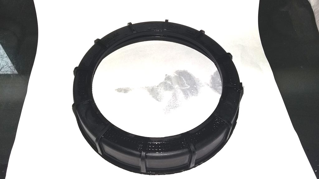

PM me your address....I have a spare (07) you can have.
If you wish to use the car before it arrives, do not fill the tank more than 3/4.....I lubricate the ring threads and seal with petroleum jelly before I replace the sender....

Re: Citroen Parts List - Xantia
Excellent - looks just the job - most kind.
