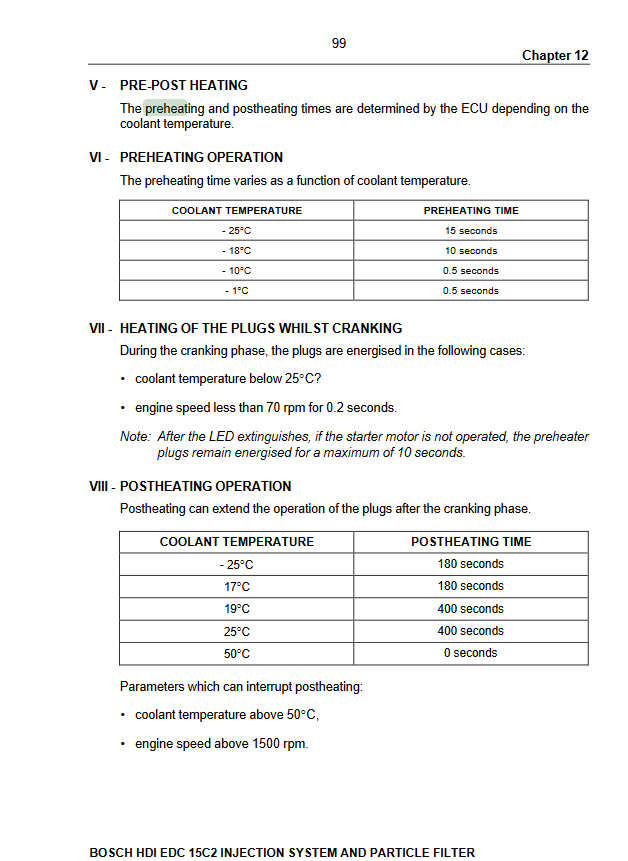

Our 1.4HDi definitely pre-heats complete with a glow plug light on the dash, if the outside temperature (and presumably coolant temp, as it's stood overnight) is below +5c
I have heard a lot of people quoting a temperature of -5c for pre-heat on HDi but as said, the 1.4 at least definitely does it below +5c. Only for a second or so at that sort of temperature but longer the colder it is out. And yes, I have tried turning the key straight away and yes it does make a difference to cranking times. Only takes 3 or 4 sec to start on a straight turn but fires within half a second if allowing the light to go out first.
I've also seen a Citroen document posted on here not many months ago charting air/coolant temperatures and pre/post/regen heat cycle times for a 2.0HDi FAP.
So in conclusion, the HDi DOES use the GPs for pre-heating BUT not very often and it would likely still start eventually even if they were all dead (unlike the indirect XUD which needs good plugs for decent starting even in summer & refuses to start at all without them in cold weather).
Perhaps if somebody really wanted to gain some empirical evidence, they could substitute their HDi's coolant and outside air temp sensors with suitable resistors to tell the ECU it's something approaching -20c & then connect a voltmeter to the glowplug circuit and see what happens when they switch the ignition on...

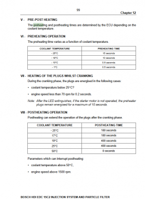

Here's something I found with relevance to the DW12TED4 engine, not the BTED which mine is but it still has some answers, see attachment.
Taken from page 109 of this document (page 99 from the numbers on the actual document, but 109 of the PDF)
http://citroeny.cz/navody/c5/System_Bos ... cky%20.pdf
