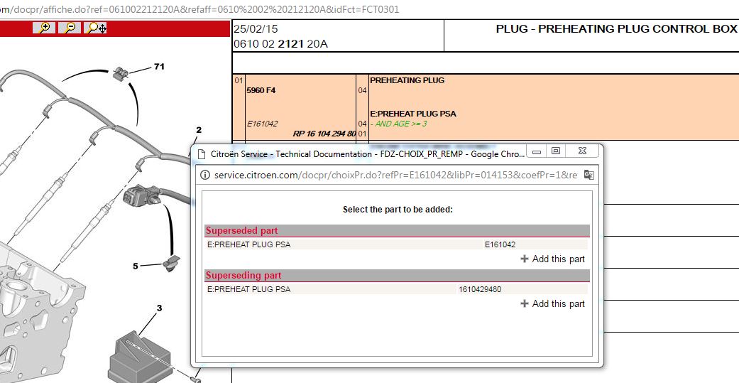

I want to change the glow plugs, but I am confused a bit. In the technical documentation there are 3 kind of glow plugs for my engine. What I need? What is the different between them?

5960F4 is the original part.
A cheaper replacement part for use on older cars was offered; E1620042, but this has been superseeded by part number 1610429480.
So you can use either the first or last part number - the latter will be cheaper, and slightly lower quality.
