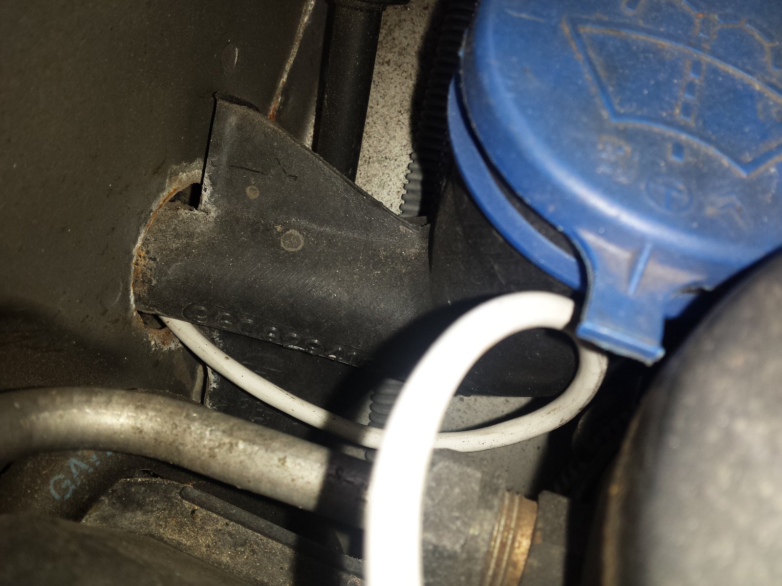

Threading the cable isnt to bad, you can go out the side of the A pillar near the loom to the door, then inside the A pillar, turn forwards, behind the arch liner theres a grommet in the A pillar, pop it out and thread it out...
You can then take it over the top of the arch liner and in by the washer bottle filler and into the ECU box..
