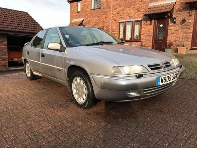

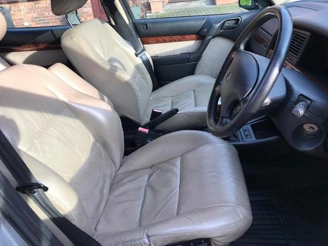

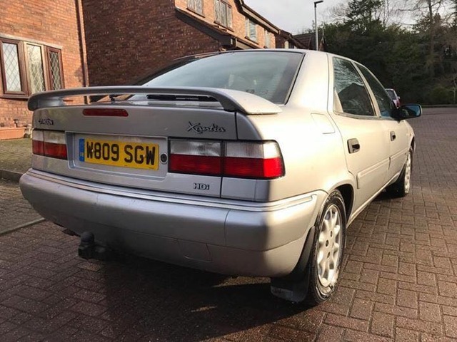

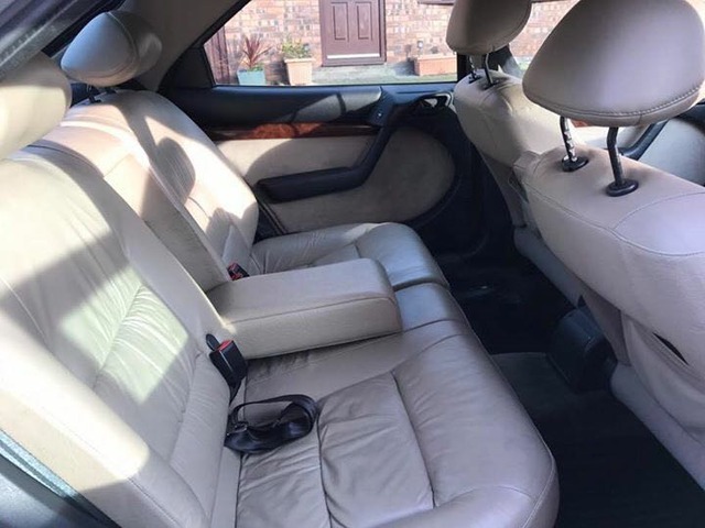

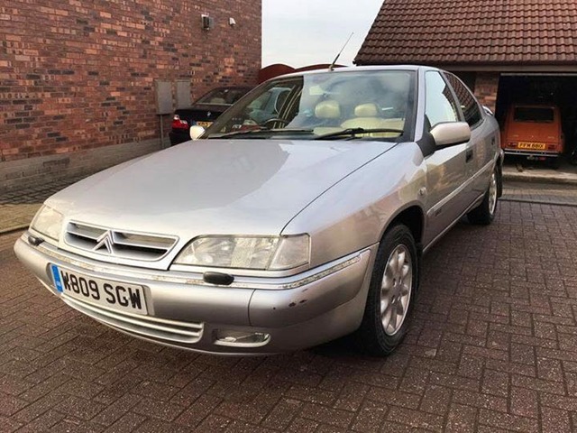

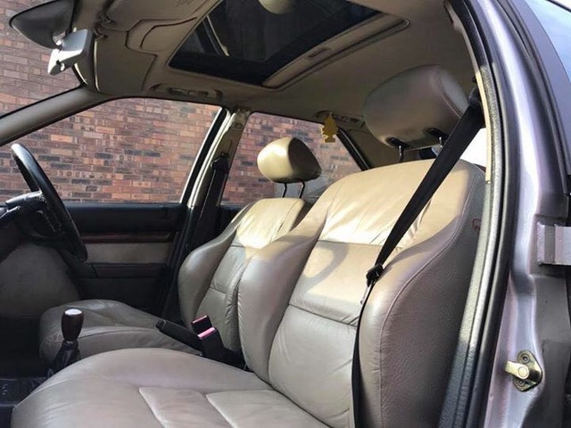

Ive been handed a Xantia HDi 110 Exclusive to sort out.
Car was bought for 150 quid. On a W plate.. in silver. . With slightly rarer cream leather and suede leather trim door cards. Pictures to follow when ive taken them.
Its NOT mine.
