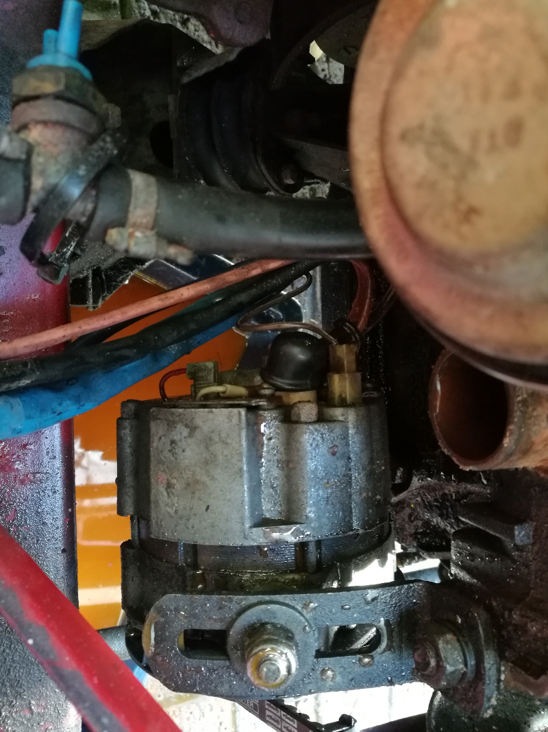

So from above to start with, this is what you can see of the alternator. I pulled the battery out just because it takes ten seconds to do and because it was in the way. Had already been disconnected obviously given the planned work.
It *immediately* became apparent that I was going to need to bring into play the "torque amplifier" (a.k.a. old bit of exhaust pipe) to get the adjuster bolt free as it was Really Rather Tight.

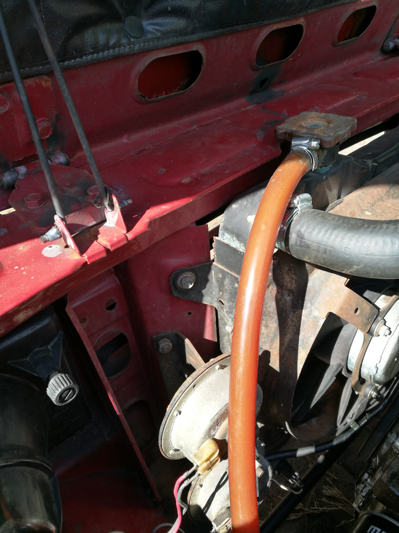

Scratched my head for a moment to figure out how I might go about getting that into the equation, and the answer I came up with was to take the radiator out. Now, this is a rather different ball game to doing that in a Xantia...
You need to remove this bolt...
This bolt...
Disconnect the hoses, unplug the wires to the fan motor and thermoswitch. Then it just lifts out.
Three more bolts remove the fan shroud from the radiator itself - I wanted this out anyway as it really could do with a rub down and a coat of paint.
Now it wasn't done in *quite* that order, on account of not being able to get the hose clip off the bottom of the radiator initially (you've heard me complain about the old Soviet made hose clips before...), so I actually ended up removing the radiator with the bottom hose and the thermostat still attached, then removing the hose clips where I could actually get at them. Every single one of these was weeping anyway so this was a good excuse to get them off to be replaced with proper worm drive hose clips. This is how many have been destroyed so far...
After about an hour swearing at them and several scraped knuckles I managed to get all the large bore coolant hoses off. Will give the radiator a thorough back flush, rub down and some paint before it goes back together, and give the header tank a good clean too as it's got some 24 year old gunge in the bottom.

Managed to get the top nut undone without any problem...then proceeded to get defeated by the 19mm one on the bottom. Not enough room to get a breaker bar on it...so will dig out the 1/4" drive and an appropriate socket tomorrow as that's got a much bigger handle on it, hopefully I'll be able to crack it off with that. I've left is soaking in penetrating oil too.
I don't particularly want to resort to heat for obvious reasons (i.e. that the bolt in question goes straight through the bottom of the alternator casing).
