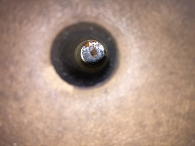

To remove door trim, you have to remove armrest. The screw heads seem a bit different. Straight notch, but with an apparent little circle dimple in the middle. See attached photos. I don't want to strip the bolt. Can you just use a thicker straight head? Or is it a more specific tool?

You should be able to use a standard screwdriver for slotted screws, that's all I have ever used. It just needs to be narrow enough to fit in the recessed slot. It will not be a perfect fit, but should be enough to turn the screw. The 'tricky customer' will be the window winder. There is no pin or metal clip retaining same, it takes two flat screwdrivers to lever them off. Take precautions to avoid damage to the cloth fabric. Also, when popping the door card from the door, use some plastic from a discarded milk bottle or some such to save paint being scratched. The door opening/locking mechanism is simple enough, just prise the plastic cover off to reveal the fixing screw. You will have to 'unhook' the tang from the rod within the door.
PS: If you are taking the velour from the door cards, be aware that they are heat glued (by some process) onto the cards to achieve that lozenge pattern. It's one swine to get them off, and they will never look the same once returned - unless some specialist method is applied (whatever that might be!!).

Yes, just a normal flathead to remove. As also stated above, the winder handles are a real pain to remove. Just be very careful as plastic can go brittle through age. Getting them back on is fun!
