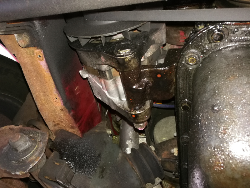

Now the alternator is (save for the steering box) about the most difficult to get to thing in the engine bay. It's buried down in the offside front lower corner, and the exhaust manifold, water pump, thermostat and the battery tray are pretty much entirely in the way. Should be easy enough to get to from underneath shouldn't it? Oh...Luckily that splash guard comes off.
Twenty (no, really!) bolts later, and access is rather better I think it's fair to say. First thought: "What a mess." 99% of that oil I reckon is coming from a combination of the rocker cover and timing chain cover. Both of which I have new gaskets sitting here for, and a front crankshaft oil seal too. The coolant is coming from...well...every blasted joint that I haven't changed the hose clips on yet it seems. Barely uses any it seems - but I think that's more down to the fact that it's got a large expansion tank rather than that it's not leaking...
I've ascertained that it's not just an external dodgy connection to the alternator, nor is the bulb in the dash to blame (annoyingly...). So will need to pull the alternator and take a look. If I'm really lucky, the brushes will just have stuck in their holder like happened with the Saab. If I'm not lucky, it will be a larger problem and I'll need to go looking for a new one or to get it reconditioned...

Splash guard is made of silly thick metal for what it is - could probably jack the car by the thing! Not quite as mad as the sump guard on the Saab which is about 5mm thick.
Guessing my problem here is going to be similar to the issues Xantia alternators tend to have after being drowned in LHM...
Speaking of, what is it then that actually stops them working? Crud accumulating on the brushes/commutator or does it cause damage to other components, insulation etc?
Given I've lost the warning light here as well I'm guessing either the brushes have stuck in their holder or the 12V that should be there to provide the excitation current has gone astray - will double check that's getting *to* the alternator before I pull it out. Definitely getting to the dash as it shares its positive feed with the oil pressure light which is working.

- Posts: 12565
- x 1484
Re: Zel's Fleet Blog - Pug 107, Saab 900, Lada Riva, Skoda Estelle & Sinclair C5
Try giving it a whack - if the brushes are stuck this may free them off and start it working again (although it's a sign that it needs attention!). The dash light is earthed via the brushes when the alt is not turning. When it turns, this current excites the coils in the armature to set up the induced currents in the stator coils - once these start producing electricity there is no potential between the light and earth so it goes out. If the light is not on at switch on (and the bulb is OK) then the brushes are not making contact (hence the shock as above). This will not work if they are covered in oily crud of course....
