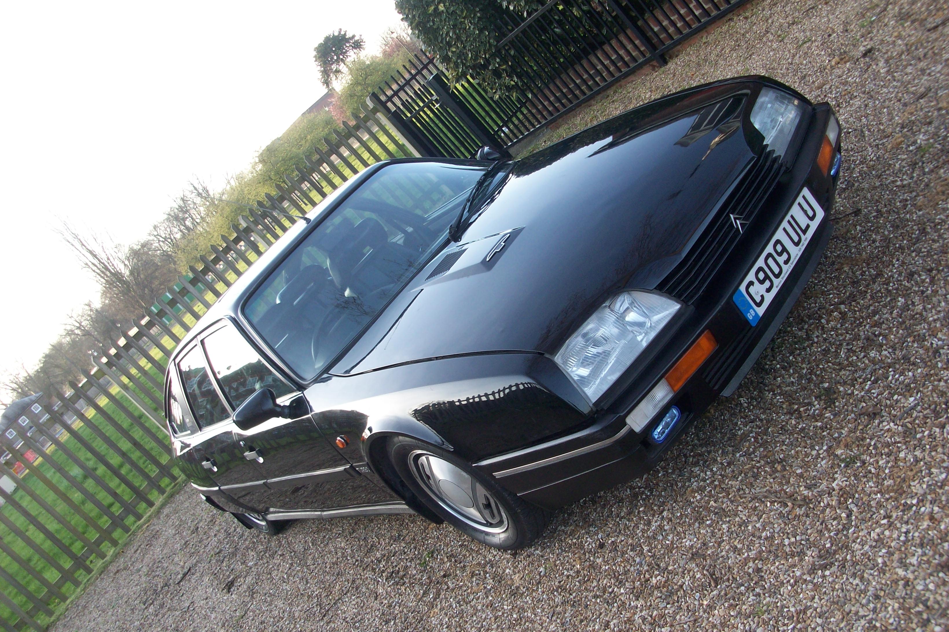

I've just been lucky enough to aquire a Series 2 Turbo 1, and I'd forgotten just how bloody wonderful they are! Black, with black leather, this may (should) ! be the CX I finally keep!
It's just come out of long term storage, has been MOT'd, and I'm just using it-always the best way to find out what's wrong! It's very good actually, very quick (I'd forgotten!), and all the big important bits seem fine...
It's got one small issue. From a closed throttle in the lower gears, it's got very jerky pick up. It idles fine, pulls smoothly, no flatspots, but it's just hard to feed the power in from zero throttle. I can get round it by dipping the clutch, but I don't want to do that! :shock:

Wo, that looks good! Expected much worse when you were describing it to me! Good luck, I am sure it's a good one.
