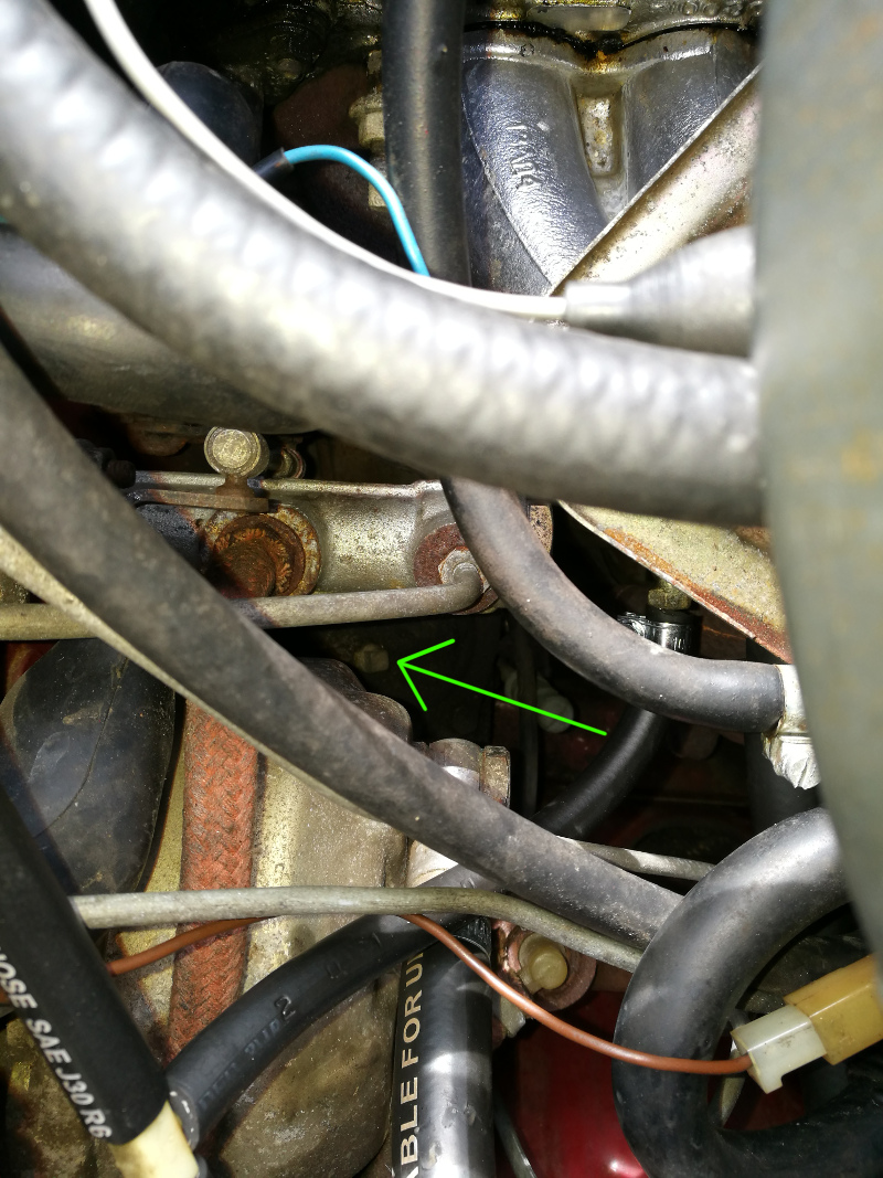

Have had a crawl around under the car and confirmed that the fuel lines (flow, return and vent) are indeed metal save for tails at the tank and engine end. Should make piping things up a lot simpler as it should save me having to route injection rated hose the whole length of the car. Also noted that the new fuel pump is almost exactly the same diameter as the ignition coil...so I reckon I've found my fuel pump bracket. Waste not, want not and all that...
Having had a look at thing I reckon that I'll probably pull the radiator out when I do the conversion. It will make getting at the crankshaft pulley and timing chain cover a massive amount easier, plus it gives me a good chance to give the radiator itself and the fan shroud a coat of paint which they could both do with. Tempting though it would be to just polish the (brass) end tanks on the radiator it would look rather out of place...
Speaking of paint, really need to give the rocker cover a clean up and paint too, that being flaky is really bugging me.
Also on the subject of paint, here's the comparison between the original paint on the Riva's air cleaner (which is in surprisingly good condition compared to most), while the new paint isn't an exact match, I don't reckon it will stick out too much once in the engine bay.
So tomorrow's task will probably be to look at tracking down a socket for the crankshaft pulley...If I can get that cracked off, maybe will get that and the timing chain cover changed...especially as that won't affect the actual running of the car. Just be nice to actually get the first thing actually attached to the car.
One thing I did forget to crack off was the lambda sensor, will go and find out how impossible to shift that is tomorrow - though I do at least have a proper wrench to undo it...fingers crossed.

Not much to report today.
Bought a 38mm socket, so should be all set to get the crankshaft pulley bolt off.
Continued attempting (and failing) to get the gearbox oil level plug out. It's (I believe) a 14mm hex socket, not that unusual. I've got several sump plug removal keys which should fit. The *problem* is that there is all of about an inch of clearance between the side of the gearbox casing and the inside of the transmission tunnel...and each and every one of the tools I have for the job are about half an inch longer than I have space to play with.
The Lada actually included a tool for this job in the factory tool kit (it looked like a really stubby Allen key)...unfortunately I wasn't lucky enough to get said toolkit from the previous owner, and I dutifully gathered up all of the components of the one from my previous Riva and passed them on when I sold it.
Thinking about it, really should keep my eyes open for one of those on eBay etc as it honestly does contain virtually every tool that you're likely to need to completely dismantle and reassemble the car. Plus a pump for the tyres and an inspection lamp...and a couple of tools that I never actually managed to identify the intended function of.
