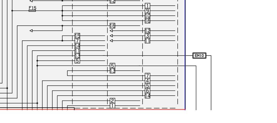

Need better wiring diagram - I wonder if beelim can post the whole diagram (s)? I'll have a look in my 307 manual and see if it is anything like it. It seems a bit odd that pin 13 is switched by the ECU, and acts on a relay that also feeds the ECU! What does the handbook say fuse 8 is for?

Anyway, I think there is enough info to move forwards a bit... If you earth Pin 13 then things start to work. So, this suggests that the BSM is OK, but the earth function from wire 13 is missing. Now, this appears to be switched by the ECU (assuming that that is what item 1320 is). So, either there is a wire fault between the BSM and the ECU, or the ECU and earth, or the ECU is goosed. So check for continuity between Pin 13 and pin F4 on the ECU, and then pins L2, L1 and M1 and earth on the ECU. If these fail, then fault found. If they check out, then looking like the ECU is goosed. Did this happen spontaneously, or was something done to initiate it?

I had a another thought... perhaps there is an ignition switched live direct to the ECU, which then prompts it to earth pin 13 and activate the relay. My 307 book indicates F8 is also to do with the cooling fans, but there is no diagram for the injection ECU unfortunately.

Hi , Thank you for the help, We got it as a non runner, I will do some of the wiring checks you suggest. not sure when, as I have a busy day today. It has to be something stupid, as When I earth out pin 13 it runs perfect. The L1 L2 M1 I take it should be the earths on the ecu?. It is so hard to see any markings on the plugs. I will have ago. A full wiring diagram would be good, all the ones I have seen are for Morreli Or Sagem ecu and mine is a Johnson controls one. just one other thing. With the screwdriver earthing pin 13 I managed to do a code check, Nothing on the main ecu but on the abs I got this.

I have never understood why the Peugeot diagrams are inferior to the Citroen ones, they only show a small portion of what you need.

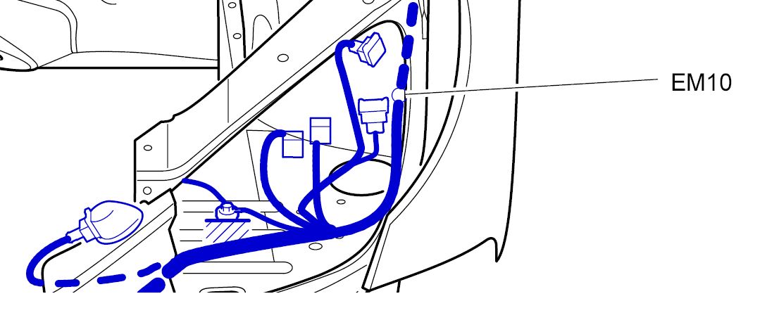

There should also be a 3rd part of the diagram that shows component locations. I would be looking for splice EM11 & earth point MC11 first.
1320 is the injection ECU & remember that those earth wires are on the 48 way black connector of the ECU. This is of course assuming this is the correct diagram for the car.

Got some more diagrams here. It seems that the earth coming from pin 13 goes to an earth point near the front left light. It is also the earth point for the abs (unit 7020) which would explain the fault code.

OK, pin 13 on the BM 34 is a thin Blue wire, and on the ecu end it is a thin F4 Purple, There is 2 plugs with f4 on but one has no wire in it so it has to be this one. According to the drawing they should be the same, I will test them later as I have left my t pins at home. I will do the earth test as well later.
