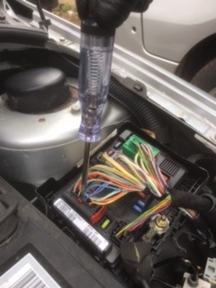

So yesterday I decided to have another go, I got my old trusty £5 test light out, Negative to the negative battery terminal and started by checking all the fuses, all are good, and now working in the bm34 unit under the bonnet, I thought I would check to see where I have power, Back probing the connectors, when I got to the Black far left connector, A very thin Blue wire, No chance of getting the number on it as it is so small. as I back probed it , a lot of clicking going on around the engine, So holding the test light on this wire, I got my mate to turn the car over , and it started, several times, but as soon as I remove my tester it cuts out.
before I go too far stripping the loom to see where the wire goes, Does anyone know what that left connector is for.
The other thing, when holding the test light on the back of that blue wire, the test light lights up, not bright, but it lights up. I don't understand why. if the test light was giving something a good earth it would not light up, but could it be that I am switching something on by earthling it out making it live?. like negative earth switching?.

Sorry for the confusion, \it does not crank or start until I connect my test light to pin 13 on Black connector PM1 Noir .

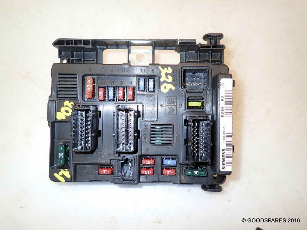

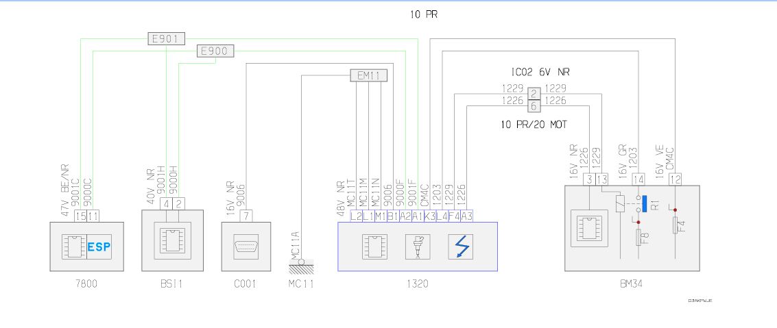

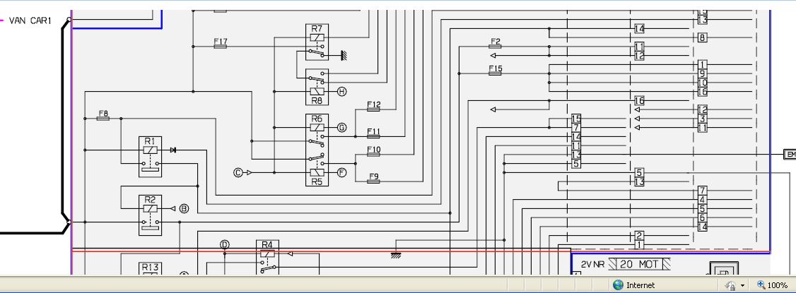

I would go with a bad earth connection . the diagram attached shows pin 13 on the right side (the black connector) as being the earth from a relay and probably more than one ie fuel pump relay too.

No need to find the fuel pump relay as all of the relays are sealed together in a unit. The fact that they are all not working and do work when you jump the earth connection says that a bad earth is the problem. The earth cable will come from this sealed box of relays. It looks like this and the relays are inside it. Check the earth wire coming from this. Ie disconnect and clean it.

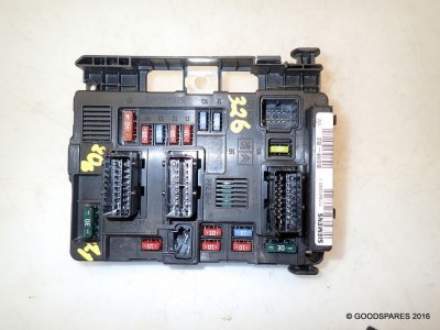

Hi Paul, If you look at the picture above of the BSM , above the number 10 is a silver earth where the bolt goes through to hold the part to the body. That's what you need to clean up.
