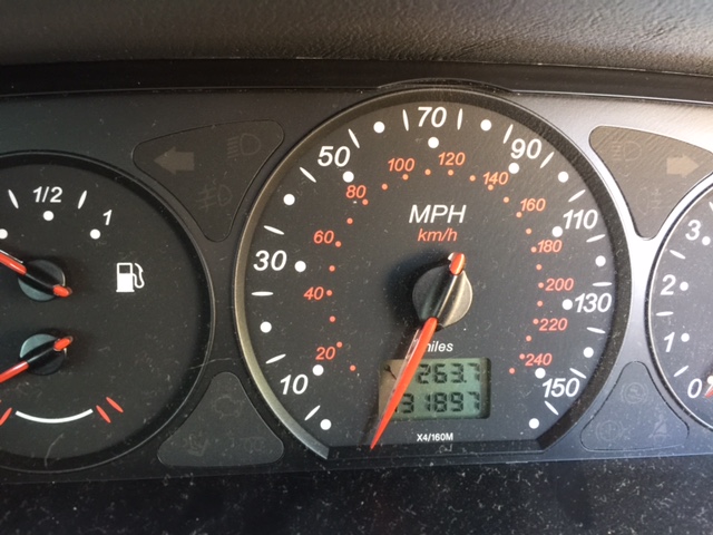

Coming up the M6 speedo showed 60 app showed 66
Speedo showed 70 app showed 76
So basically the speedo is showing 10% under the app

Definitely something wrong then as the speedo should over read by about 5% not under read. I would be strongly inclined to believe the GPS reading. How strange!

In one of my earlier posts there was a link to a similar issue with a C5. It explains how to take the instrument binnacle out (just need two credit cards or similar), and how to swap the stepper motors over (between speedo and rev counter). If the motor is at fault a new stepper motor is supposed to cost around £25.
Here is that link;
http://www.roadtestreports.co.uk/qanda/88959/

Where's the speedo pointer when the car's at rest?
Maybe it's had a new stepper and the pointer put back on wrong.
Hadn't thought of that !! Will check in the morning

Now that is a thought. I have noticed that the speedo is consistently 4MPH out. If it were a tyre size issue I would expect the difference to change as the speed goes up (but the percentage to be the same).

following on from Gibbo's point yesterday, the pointer is here:
which does lead me to believe the pointer is out, now for the strip down..............

Definitely looks out!
But where should it be aligned ? On the first dot ? It's not always obvious on some speedos where the 0 position should be...
Does anyone have the same style speedo on their C5 who could post a picture of it sitting in the rest position ?

See this one: E-bay C5
Fourth pic shows the dash, and if you zoom in you can see it's pointing at the dot below 10.

I've just checked mine and the pointer is sitting precisely on the round dot, the handbook pictures also show it in the same place.
