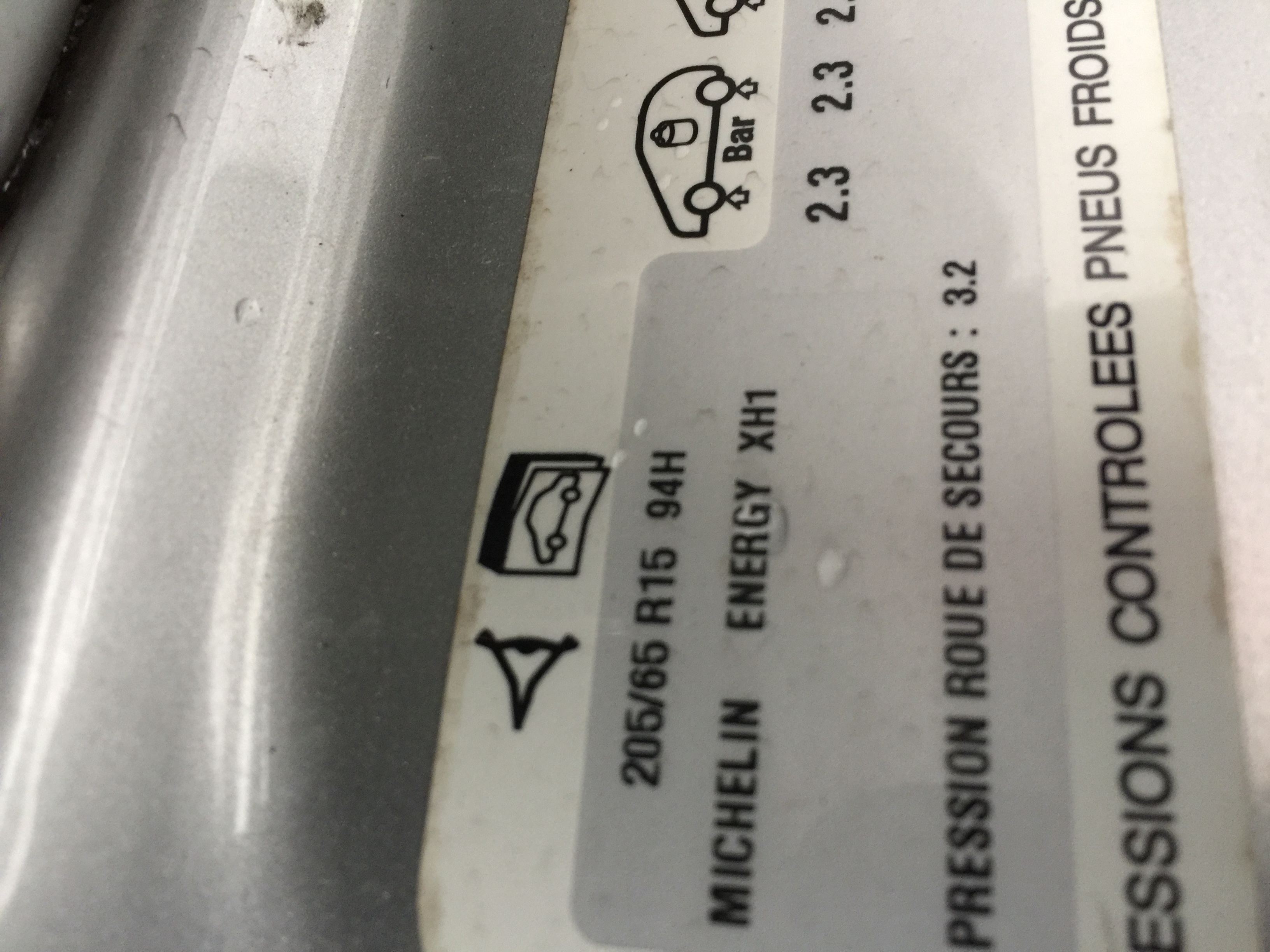

Yes, to do the maths and compare to see if the speedo would be affected the oem tyre size (as on the door label) is needed.

sticker says 205/65 R15 94H

And do the tyres match?
Posts: 28533
x 5612
Re: It's been a while (C5 Adventure)
Trainman wrote:sticker says 205/65 R15 94H
That is the same as mine and my speedo is very accurate.

Your speedometer error is unlikely to be down to tyres then. You are -1.7% from OEM and your speedometer should over read by about 1 mph all the way up to 100mph.
