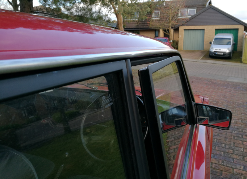

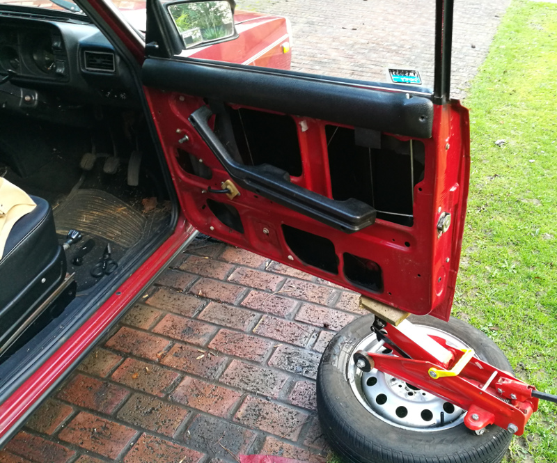

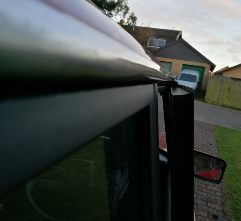

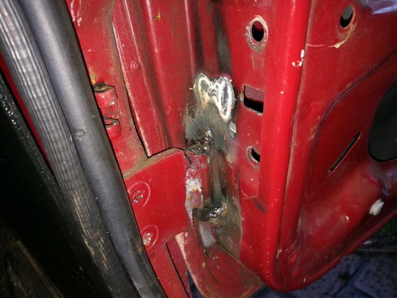

Think I've figured out a good reason for that setup in the welder - it makes it far easier to spot that it's lit outside in daylight than if the lamp was the same colour and blended into the colour of the switch.
So here's how wonky the driver's door was beforehand...Not hard to see why I had to perfect the "lift and slam" technique to close it.
Things propped in place before welding - yes, I did remember to remove the door handle before I started.
It was really quite fiddly to get into the corner where I was trying to do the welding - especially as I couldn't really get my head in close enough to see what I was doing once I had the welding mask on..still, got there in the end. Judging from the other side of the panel, I got at least some reasonable penetration with the weld. Couple of braces on the outside of the door attach the top and bottom of the hinge to the frame as well.
Here's how things looked afterward...

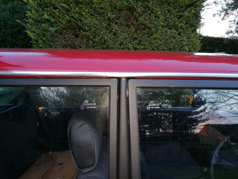

You can pretty clearly see the mark where the door's been scraping against the pillar when opening/closing.
Bit better I think!
Actually looks further out in that photo than it does in person. Just the angle I think.

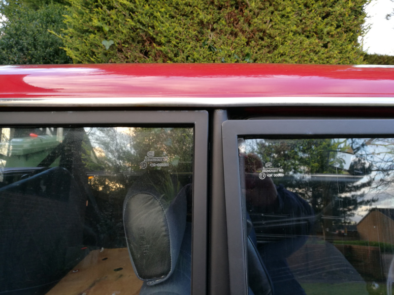

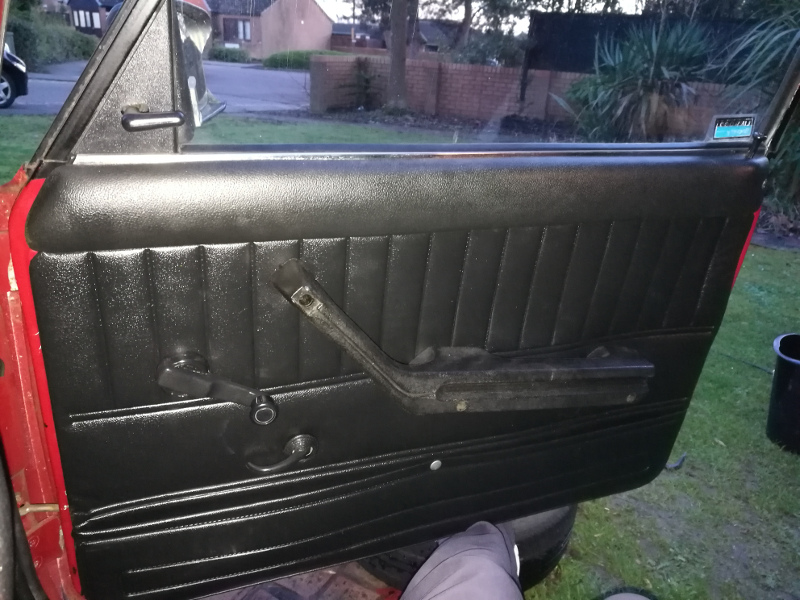

Before I put things back together I decided to address one issue which tends to cause trouble in Ladas. The door cards are essentially just that - just really thick card...fine and good until they get wet. Simple enough solution really, stick something waterproof on the back...Had the underbody sealant handy from when I hosed down the inside of the door with it.
Putting the door back together thanks to the simplicity of these cars is the work of about five minutes.

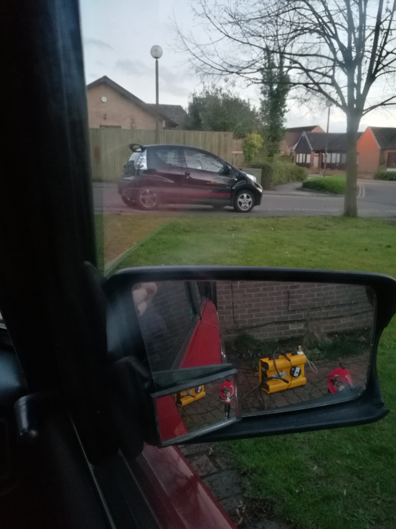

Looking in the wing mirror you used to be able to see a good 1/2" gap between the top of the rear door and the front one - looks rather better in the mirror now!
Really need to get rid of that blind spot mirror (it points completely the wrong direction, and is less than useless), if only it wasn't attached to the mirror with what appears to be nuclear attack resistant adhesive.
