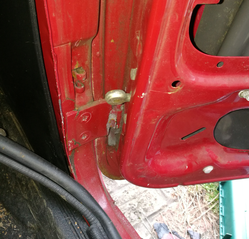

So we're back home again.
This time around, neither the Lada nor the Sinclair missed a beat during the entire journey.
Had a bit of spare time this evening though, so decided to take a look at the driver's door.
First thing I rediscovered was how much of an utter pain in the proverbial the window winders are to get off...I did eventually find where the circlip landed after about ten minutes.
As expected, the issue was that the spot welds holding the lower hinge assembly to the door frame had come away.
Also spotted that most of the sound deadening had come away from the inside of the door (as usual).
Unsurprising that the doors always rust out at the top, given that they never painted the inside of them! Suffice to say I'll be pulling the door cars off all of them and getting that sorted out...
Sorting this one out though isn't that hard. Usual solution is to just drill a couple of holes through the frame and bolt the bracket to the door frame. This does however involve taking the door off to do (as the B pillar is in the way of where the drill needs to be). Now, this is easy *if* the bolts holding the door on will undo - they have a Philip's screw head rather than a normal bolt - and it's a 50/50 gamble as to whether they unscrew or strip. Will give you one guess as to what five out of the six did.
I reckon my alternative approach will be to grab the angle grinder and cut myself an access hole so I can do the drilling from inside the door, shouldn't need to be that massive, and will be hidden behind the door card so I'm not going to worry too much about it.
If my welder was currently something vaguely resembling working I could weld it back together probably - but it's not!

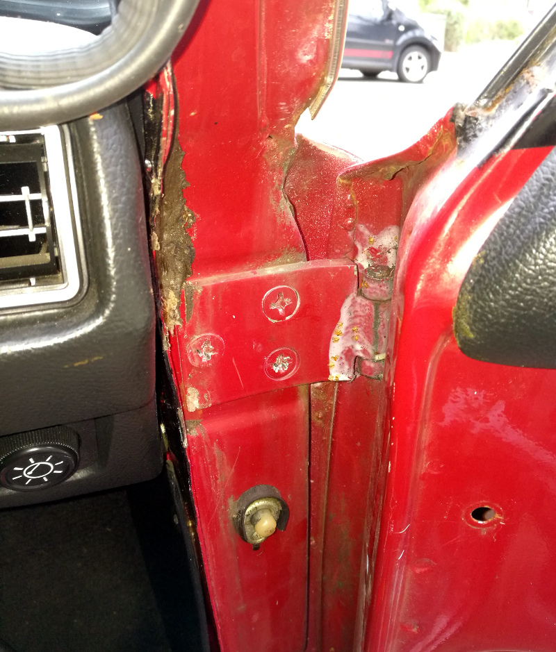

So attacked the driver's door on the Lada again today.
Firstly had another bash at actually unbolting the door from the B pillar - someone has obviously had a go at this before as the screw heads are already somewhat messed up.
There is enough to get purchase with a decent bit though it turned out, though without an impact driver, they ain't coming out.
...The fact that the screwdriver bit I was using basically exploded when I was hanging off it with the ratchet via a bit of exhaust pipe to use as a breaker bar tends to show how tight these suckers are.
Annoyed at failure there, I gave the back of the door inside a brush down with the wire brush, then slapped some sealant in there to stop the surface rust from taking hold.
It's not pretty due to some of the old sound deadening still being attached, but I'm not too worried about that. It's inside the door so nobody can see it, rust proofing is far more of interest to me than being pretty!
Even with a flexible drive attachment on the drill and the door stay removed, I can't get in to drill through from the door post side.
At this point I reckon I have two real options.
1. Resurrect my welder and weld the bracket back to the door frame. Access isn't actually too bad to do that to be honest. Cleaning up the surfaces first will be fiddly, and will probably end up being done with sandpaper and emery cloth taped to the end of a screwdriver, but it's doable. Getting the tip of the welding torch in to make the join shouldn't be too much of an issue. It won't be a *pretty* weld I fully accept, but it don't have to be. So long as it's strong enough and properly rust proofed.
2. Weld a nut onto the screws holding the door bracket on, allowing me to unscrew them properly.
I reckon that option 1 is by far the best as it will give me a "fit and forget" repair. Wheras if I bolt things together, it will never be as strong as it should be (...says the person who's come across this issue on two out of the previous three Ladas), as it will always be a pretty tiny little tab that the bolt will be holding. Will also be a pig to get it perfectly lined up trying to drill through two layers of metal with poor access.
Option 2 I reckon I may need to do long term though, as that door doesn't sit right - and the height is adjusted with shims behind the hinges there...and because I can't remove the bolts, I can't add/remove shims to make sure it sits straight! Though how much better it will be once the bottom hinge is actually *attached* to the door still remains to be seen.
The welder however is in need of a complete new torch and liner assembly...unfortunately I know absolutely nothing about how standard or not these things are between brands. The base unit itself, while ancient, is perfectly fine (and has been used relatively recently for a couple of experiments for which I needed many tens of amps of DC current!)...so probably can be dragged back into the land of the living.
I do wonder whether in the long run I'd really be better just picking up a new welder - let's face it, with my fleet it's a tool that I'm inevitably going to need in the future, and I really should learn how to use properly. This task shouldn't be an issue as both bits of metal involved are pretty beefy, it's welding to tinfoil body panels I still really need practice at. I do wonder whether a new welder (even a relatively inexpensive one) is likely to be easier to learn to drive properly than my ancient old fourteen-previous-owners tank.
Thoughts?

What welder do you currently have Zel?
OnlineZelandeth
- Posts: 5326
- Joined: 16 Nov 2014, 23:36
- x 1607
Re: Zel's Fleet Blog - Pug 107, Saab 900, Lada Riva, Skoda Estelle & Sinclair C5
Very valid question...I honestly can't remember! "Heavy and yellow" are the best I've got right now. Will check tomorrow. It's a pretty standard run of the mill MIG setup from what I recall, albeit about 30 years old...Though given the trend for tat made from recycled tinfoil from China to be sold these days, that may well count in its favour.
It's welded several of my cars back together in the hands of my former flatmate and his father before that. I ended up with it when he decided to upgrade to something more compact and portable when the torch on this eventually got to the stage where it wasn't bodgeable any further. Have always meant to sort it, just never got around to it. This might be the point where that finally happens.
EDIT: Between what I could remember of the model and Google, I've managed to confirm it's a Sureweld Monomig 101.
Current fleet:
elma
- Posts: 3745
- Joined: 13 May 2007, 02:17
- x 284
Get a new torch Zel, if it's heavy and made in the USA you'll only buy something worse or really expensive.
Torches are a consumable anyway, they don't last forever.
OnlineZelandeth
- Posts: 5326
- x 1607
That's my thinking really. I was put off last time I tried to sort this (when I first got my VW T25 camper project) as I couldn't find anything local to me and I didn't really know what I was looking for online properly, so tended to wind up going around in circles.
I know a *little* more about welding than I did back then, but at a glance there do appear to be more options available in terms of parts availability online now.
Should still have plenty of wire (seem to recall being donated a massive spool that didn't fit onto the welder that replaced this one) and a couple of unopened bottles of shielding gas as well.
Will have a poke around tomorrow. Just have to admit to having buying stuff on the internet...I may be a grumpy old man (...Aged 31...) but I'd far rather drive out somewhere, pick it up and drive home again with it than faff about in front of a computer trying to figure out what I want and where to get it. That was still true back up north when that generally meant a minimum of an hour's driving...
