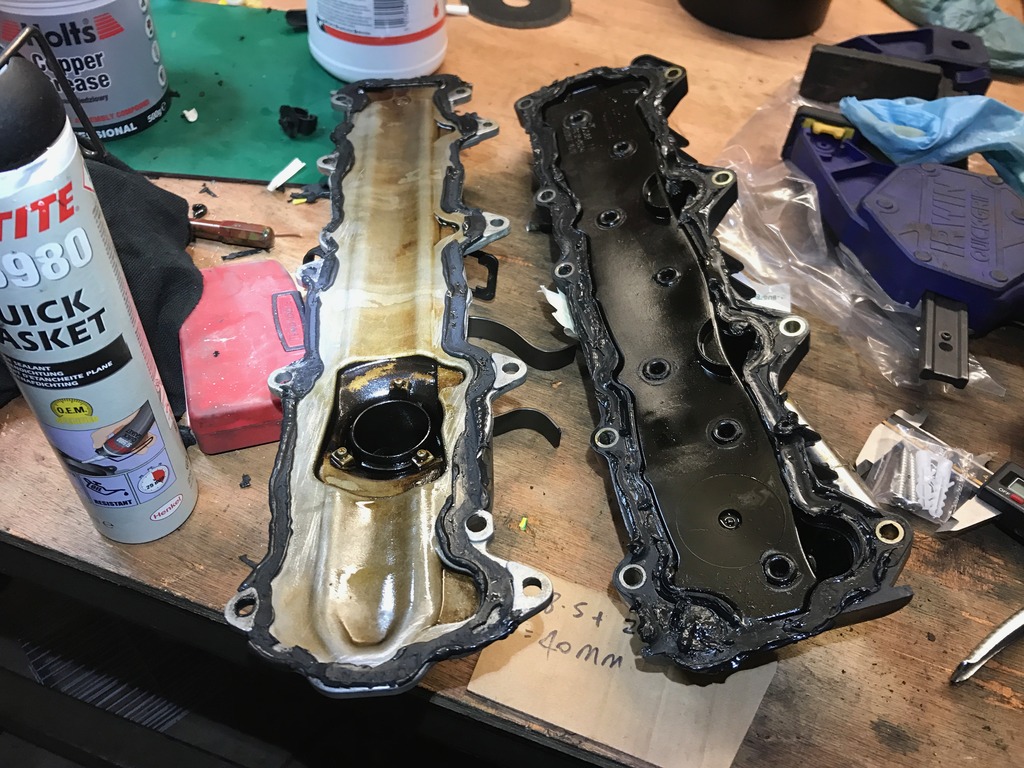

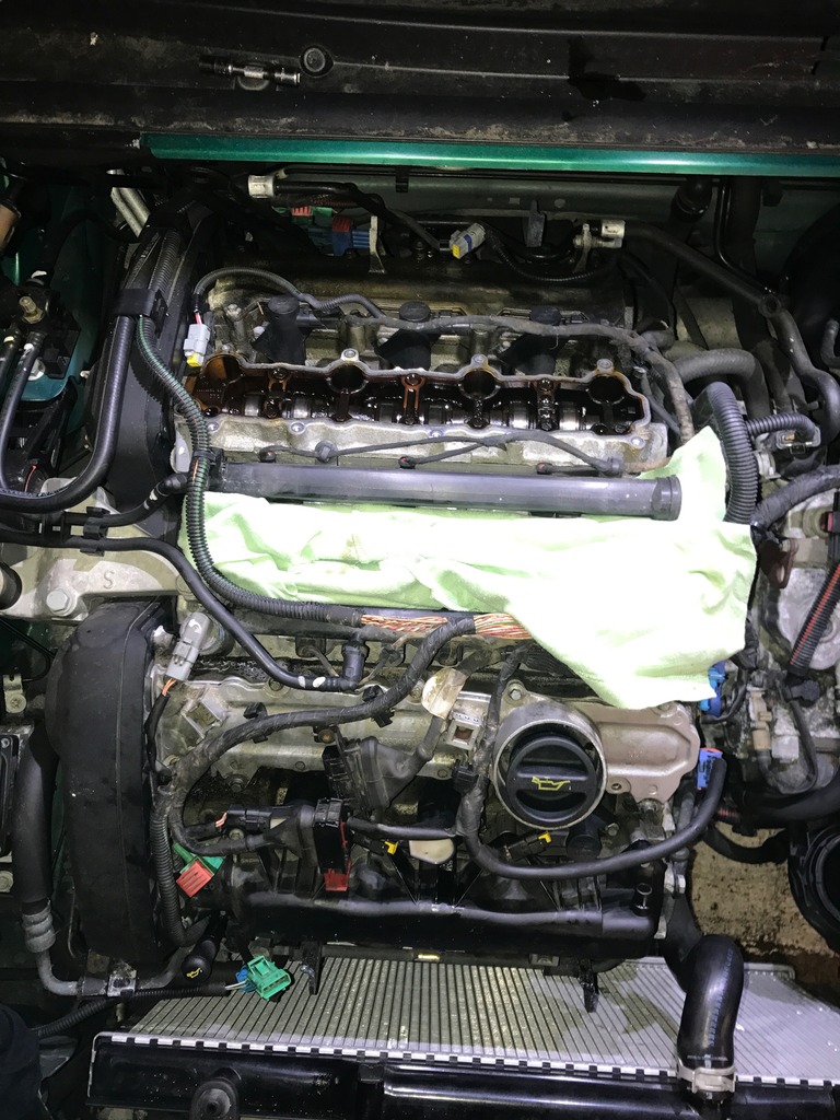

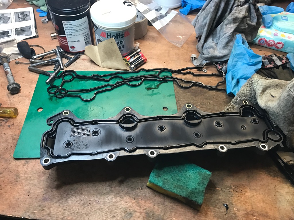

I set about fixing the rocker cover oil leak my C5 has and removed the rocker covers. It is the ES9J4S v6 with 2 aluminium rocker covers, and 2 plastic ones. For the aluminium ones i used Loctite 5980, however im wondering about the 2 plastic covers as they had a gasket in there:
Citroens servicebox isnt showing any seperate gasket for the rocker covers, would the loctite 5980 replace a gasket?

Yes, just use the same product. Make sure that you make the bead tall enough to seal the gap.

I've done the job but had a couple of covers that have continued to leak.
When I removed the covers that were leaking the sealant still hasn't fully cured. When applying it I made sure the area was fully cleaned and degreased, applied a good bead and then waited for 25 minutes, installed the covers then waited at least a week to let it cure. In actual fact its probably a few weeks since they were applied. The plastic cover especially where the sealant went into the gap for the old gasket was the sealant still was quite soft.
Should I keep the covers out in the air for longer to let it cure more before bringing them to the car?
