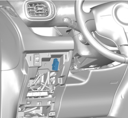

This is a petrol 1,2litre, 110bhp. Can anyone please tell me where to find the diagnostics socket?

C3 Picasso 2016---- where is OBD2 port?

According to the Citroen Service Website "The diagnostic socket is located under the dashboard lower trim (left-hand side)."

As Stu has already said above, the diagnostic socket is on the left hand side - this picture shows a LHD vehicle - but ignore that - it will 99.9% be in the same location, even if the trim panel is different:

For obd socket locations i use this site > http://www.wikiobd.co.uk/manufacturers.php?pt=1
I normally find it very helpful
