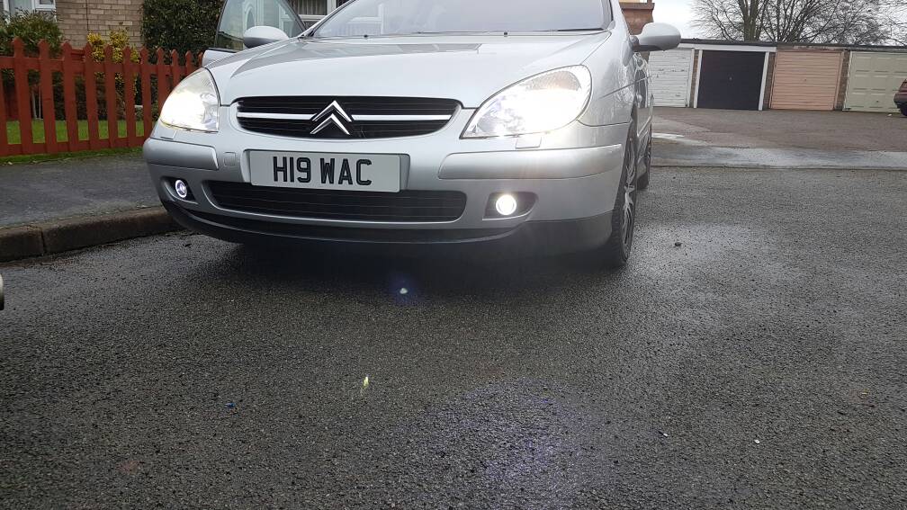

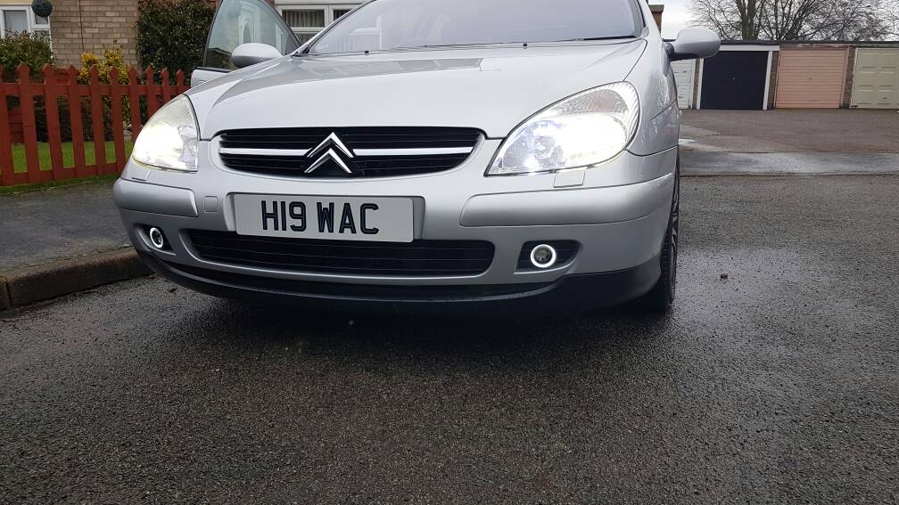

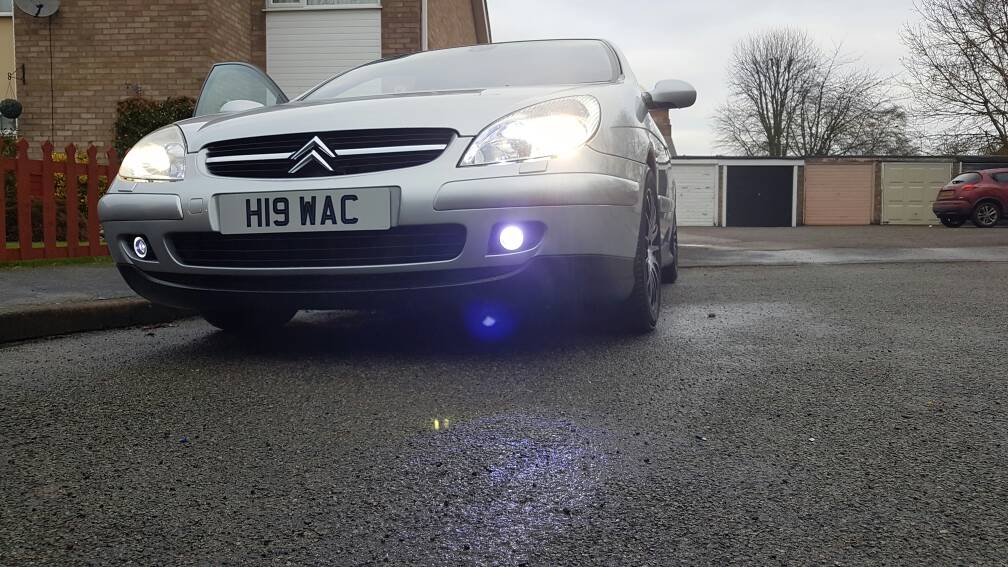

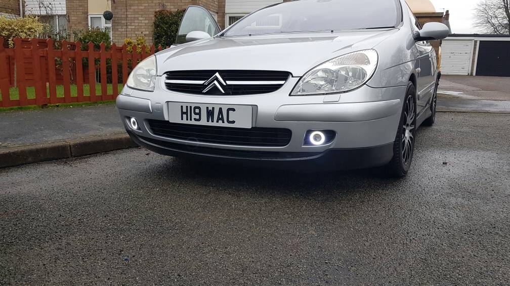

Been after some round lights for ages to fit in the bumper as below. May not be o everyone's taste but it's an idea to other mk1 owners...is there many here?
Daytime mode.
Half brightness with headlights on.
And with fogs on.

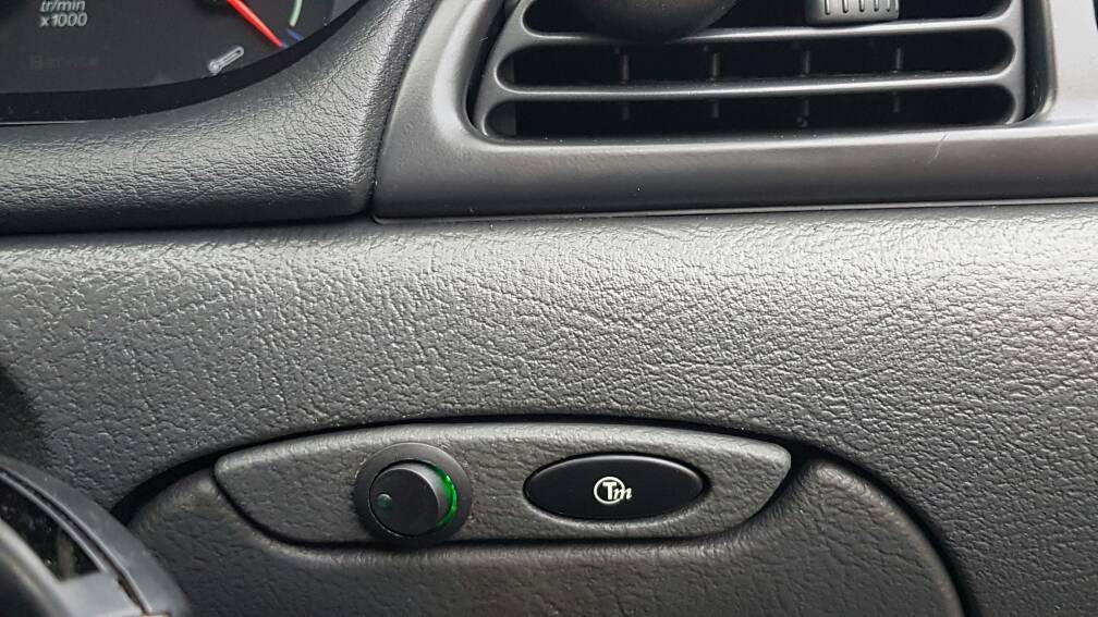

Did have a better fog switch but the terminals were rubbish so had make do with the one above. Took the swith apart and fitted some tape to the inside as the led was to bright, lights up at the rear of the switch as seen which is OK.
Mmm what's next running out of ideas..

Definitely like the look of those. I was thinking of putting something similar on as fog/spot lights. Do you have a link to the seller and some details of wiring them in?
hirsty
98 Xantia Mk2 2.0 16v Auto Exclusive 160k + Now gone to Citroen Heaven
2004 C5 Mk 1 2.0 8V VTR Estate - current. Now with leather.
waynedance
Posts: 973
Joined: 29 May 2011, 22:56
x 8
Re: New DRL'S fitted to the C5 mk1.
Unread post by waynedance »
http://www.ebay.co.uk/itm/361679651550? ... EBIDX%3AIT
I had previous drl but no fogs, so wiring was in place for them. I already had a relay from ebay which switches them to half brightness. The drl are wired via a relay with a direct live feed from the terminal near the battery and the switch for the relay is taken from the fuel pump fuse in the engine bay so the only run with engine running.
The fogs use the same live feed to a relay with a wire running from the side light circuit into the car to the dash switch so they only work with side light on.
Did that make sense?
