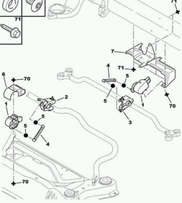

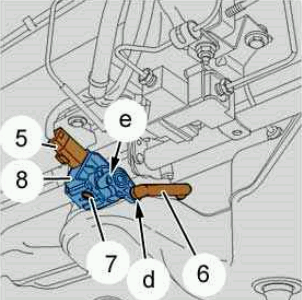

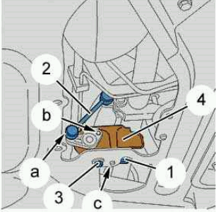

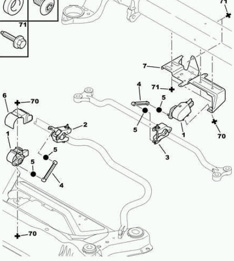

Here's some diagrams Simon: Just son't undo the clamps off the axle as this will muck up the heights further - you just need to ensure you give it a good lube and then work the suspension high and low a good few times and pray again.
Height Correctors C5 MK I
Front Height Corrector
Rear Height Corrector

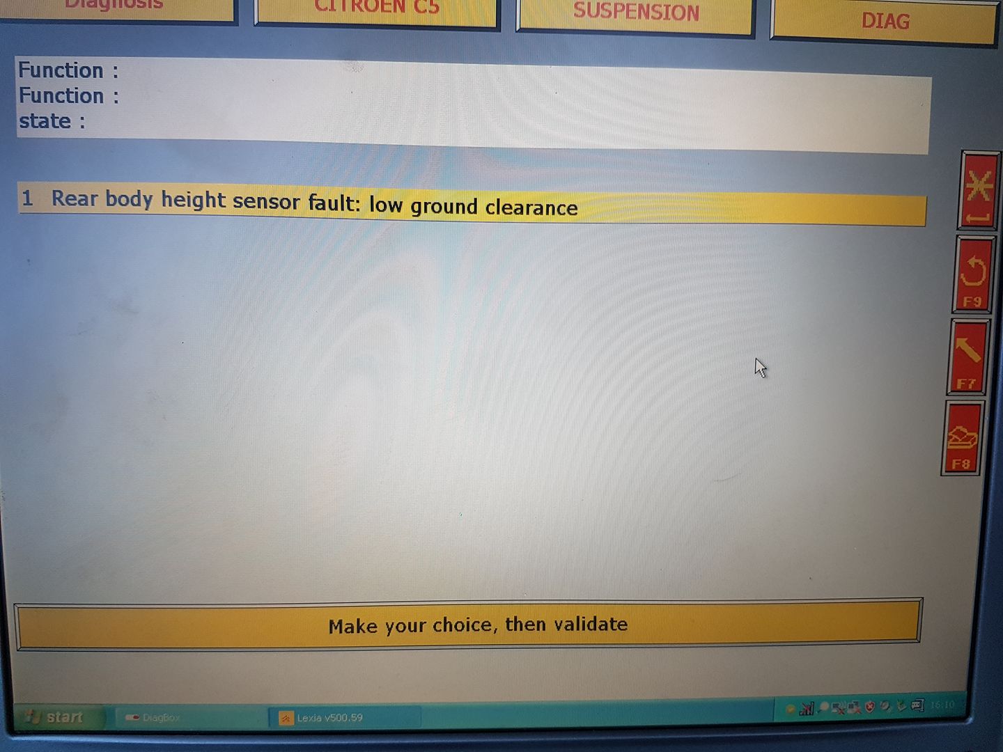

thought by getting under it and spraying and forcing it up and down would work
it did
for a day!
I'm looking at replacing the sensors - but the ecu is showing a fault *only*
and its mot is supposed to be today , can I take it in in tip toe mode for him to est *eg does it have to move up and down for the mot?)
