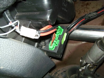

I took some photos back in 2009 the first time my blower motor stopped. I'll do my best to narrate what I did.
Own photo
Own photo
This bit of trim I think is under the steering wheel column. I can't remember why I removed it - maybe it allows more light in while working.
Own photo
Own photo
Own photo
Own photo
This trim panel is secured by a special plastic trim screw and generally tucks under other bits at the edges.
Own photo
Own photo
Own photo
Own photo
Then you can see the control unit It's held in place by two (maybe only one - can't remember) screws and you'll need a Torx screwdriver. Carefully does it as you withdraw the screw(s), I dropped one down the back of the trim underneath and never saw it again.
EDIT - I thought about this later and I think that the screws are hex head and you'll need a 6mm socket for them.
Own photo
Own photo
This shows the control unit and plug going in to it. You have to hold this little locking tab open to pull the plug out.
Own photo
Own photo
If you want to look inside the unit at the PCB this is one of the locking tabs that have to be held open to flip the top off.
Own photo
Own photo
Own photo
Own photo
Final two photos show inside the connector socket on the control unit and the PCB itself. Neither really show the heat damage so I'm wondering whether I photographed a replacement unit.

Many thanks one and all for all the advice, as soon as the weather picks up I will get into this, I hope it a simple fix I can do garage labour charges are so expensive:
Ian
GuzziG
Posts: 8
Joined: 26 Jan 2014, 15:14
x 4
Re: C5 heater motor not working!!
Unread post by GuzziG »
Just replaced this module on my 2003 C5, no issues. In my case the screws require M6 socket. Only the steering colomn UJ cover needs to be removed as in photos above. Module was £16 from eBay.
