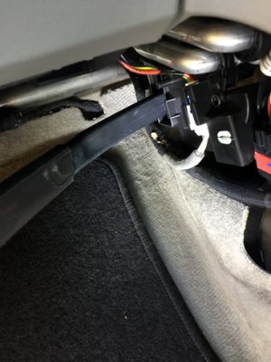

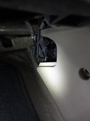

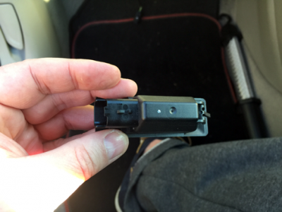

Using the Flat Head screwdriver, gently push in the small plastic lug of the Footwell Light and lever it out so that you can access the plug.
E - Lever Out the Footwell Light
Disconnect the plug by pushing in the lug and pulling.
F - Unclip the Plug
F - Unclip the Plug

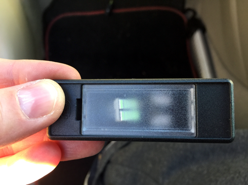

G My LED Replacement!

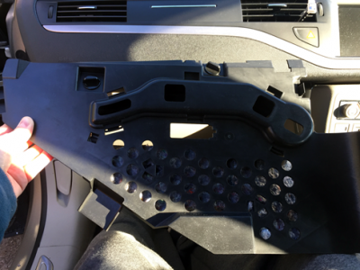

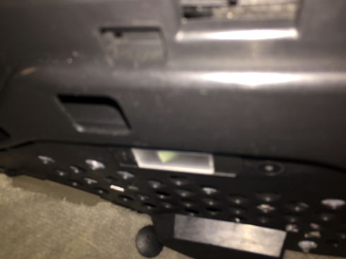

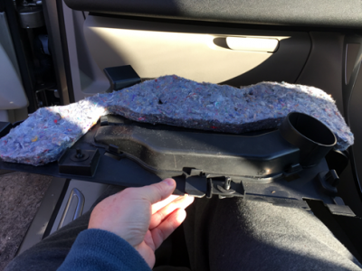

D - Underside of the removed Trim

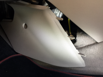

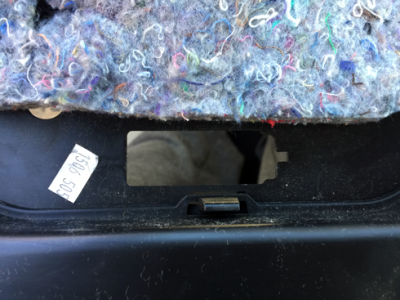

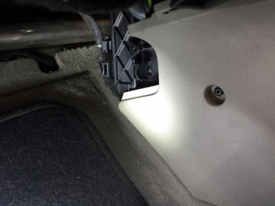

With the top trim removed, you can now see the Pollen Filter cover through the exposed recess.
H - Pollen Filter Clip

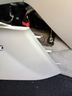

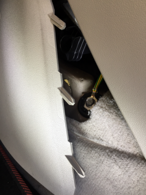

With the screw removed, gently slide the side trim forwards. There are 3 locating pins.
I - Remove Screw and  Slide Forward

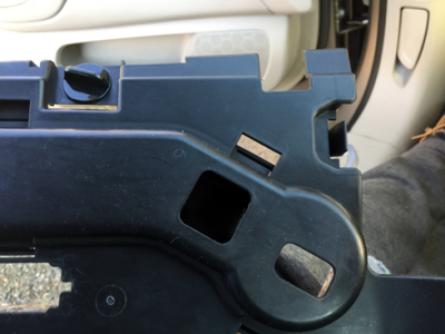

Locating Pins:
I2 - Locating Pins Exposed

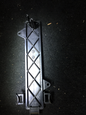

VERY GENTLY pinch together the bottom 2 lugs to release the Pollen filter Cover. Once disengaged the cover will easily pull away.
J1 - Pollen Cover Off
Note: There are 2 holes on the cover that are to allow the cover to be screwed back into place if you inadvertently break the lugs off :roll:

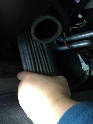

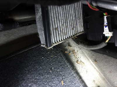

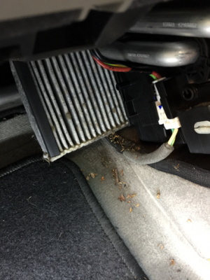

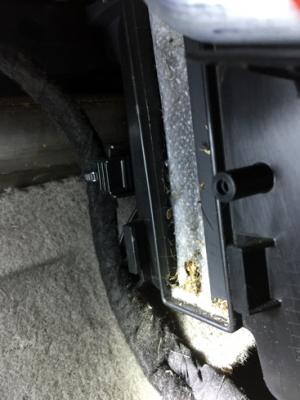

Now, get your torch in place and gently pull the filter out - be warned there will be a load of crud and bugs flying out as the old filter springs out!
J2 - Crud Alert!
J2 - Crud Alert!
J3 - More Crud
J3 - More Crud
J4 -  Ease Out Filter
As You pull out the filter, try and roll it, whilst pulling gently as there isn't a lot of room to pull it out directly.
J6 - Wrap and Pull
J6 - Wrap and Pull

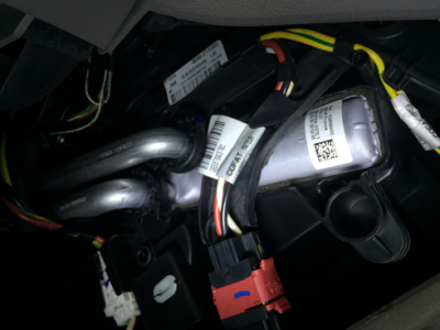

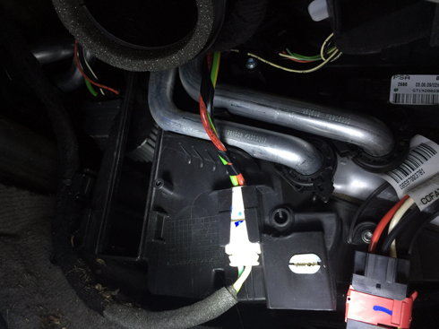

Whilst we are here - this is the Heater Matrix Location!
J7 - Heater Matrix
J7 - Heater Matrix

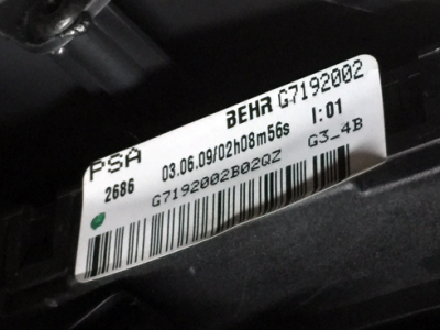

... and the Heating Resistance unit - hmm, 2 Hours, 8 Minutes and 56 seconds on the label ??? - G7192002 is definitely the Heater resistance. perhaps that is the date and time is was made - how precise!
J8 - Heating Resistance

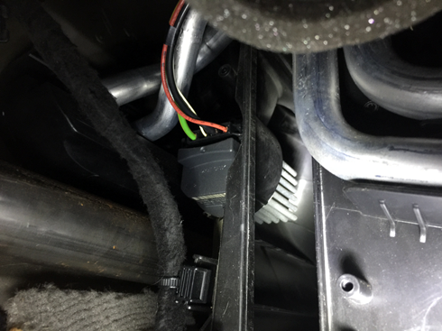

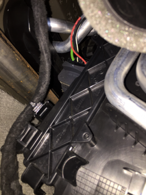

And while we are still here, this is the Blower Motor Control Unit that you can just see up through the Pollen Filter housing (arrowed in Yellow).
J10 Blower Motor Control Unit Arrowed (for Ref)
A better close up:
J9 Blower Motor Control Unit

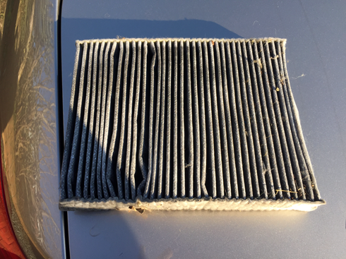

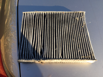

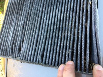

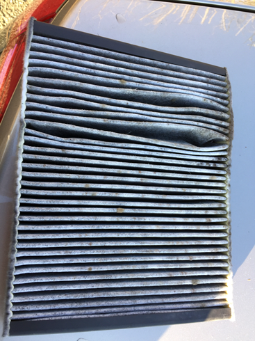

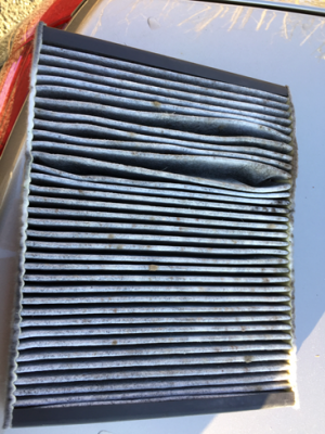

Back to the job at hand - here's the grotty filter in all it's glory:
K1 - Old Filter - Gross
K2 - Filter Crud
K2 - Filter Crud
Do I believe Citroen changed this last service... I don't think so [-X
K3 - No Way this Was Changed Last Service

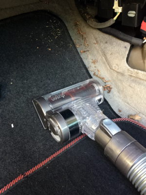

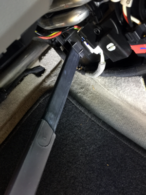

Out with the big guns - time to hoover out all the rubbish.
K4 - Time For The Cavalry
'Bugs be Gone'
K5 - Dyson With Car Kit
We bought the car kit with our Dyson Animal - it has a bendy crevice tool - great for getting into the recess at an angle.
K6 - Dyson Bendy Pipe

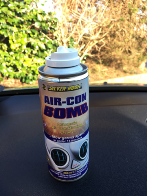

Now for the Air System Clean (whilst the filter is out)
L - Air Con Bomb Time

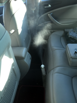

Read the instructions carefully, as you don't want to be in the car when this goes off. These all work similarly, but basically, move all seats forward and tilted towards the front of the cabin.

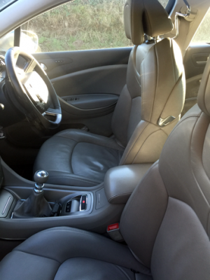

L1 - Move Seats Forward
Close all windows and doors. Start the engine and use the following settings:
All Air vents Open
Ensure Air Distribution is Generalised throughout the car
Fan Speed Full
Set Temperature to coolest Level
Air Con On
Switch to RECYCLED AIR Mode

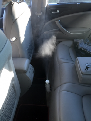

Place the Air Con Bomb in the Rear compartment on the floor in the middle. DO NOT activate it with your face looking down at it - Activate it from the side, then leg it and close the door.
L2 - Nuking the Cabin
L3 - 5 Minutes Later
Wait until the Bomb has fully discharged itself, then wait another 5-10 minutes before opening the doors.
Enter the car and switch off the engine. Put the seats back and the passenger seat down to help with the acrobatics necessary to get the new filter in.

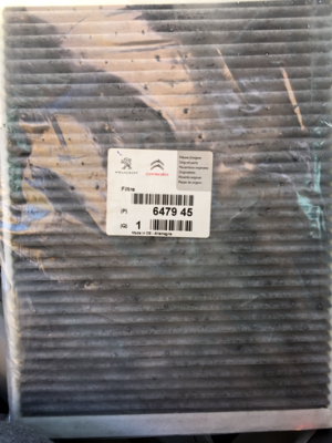

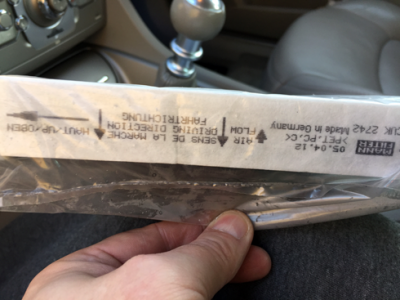

M - The New Filter
M - The New Filter

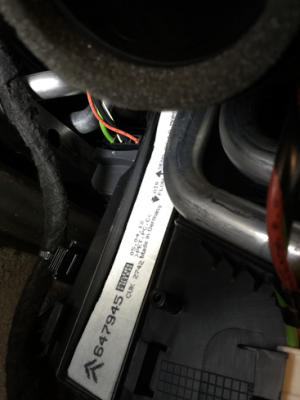

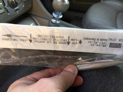

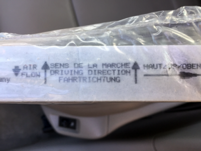

Look at the notes or instruction either printed on the filter or on the instructions - the filter is designed to operate only one way and should be positioned so that the air flows correctly from the front of the car to the back of the car in the direction of the air flow as per the arrows:
M1 - Read Notes
M1 - Read Notes
M3 - Direction Important
Get your torch again, and with the filter in the correct position, you will need to flex it gently, angle it in through the top, then at the bottom, wiggling it up and down as you gently push it in. Just keep using your fingers to push at the top and bottom equally until it goes in. Once in, pull it out slightly and give it a wiggle to help ensure that the concertina has expanded and that the filter is fully in position.
M4 - New Filter In
M4 - New Filter In

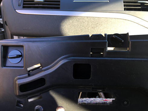

Slide your trim back on front to rear, ensuring the 3 pins locate properly, then screw back up once in position.
M6 - Slide Pins in First
