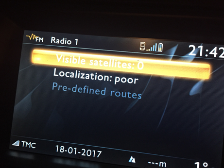

I've just bought a 2010 C5 Exclusive and I have a problem with the SAT NAV. It works but does not show the correct location. The recption says 'poor' and satalites say 0 which i'm guessing has something to do with the antenna.

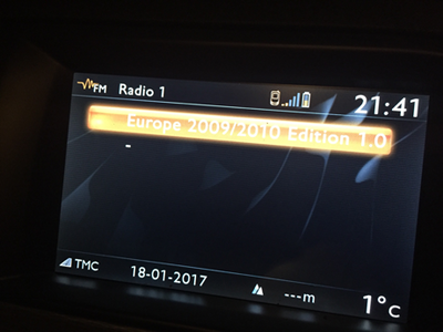

How do I find out what map version I have?
x 6954
Re: Navidrive 3D

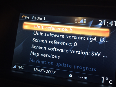

Ok, so Navidrive 3D confirmed. That photo shows the firmware version you have and is probably one of the earliest versions there is - we are now on N42.03C which is the latest one. To find your map version, you just need to hold down the SETUP button with a long press until you get the extended menu. You should be able to scroll down to get the map version.

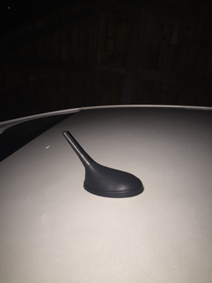

I have a question - do you have the original aerial on the roof? It should be the small black one as in this picture (a bit hard to see I know)
Yes, i think its the original aerial and map

Once you have checked the rear of the Head Unit, and if that is OK, I would suspect the roof aerial. This is an amplified unit and I've known a few Peugeot owners with this system that had the same problem and a replacement aerial solved the problem.
