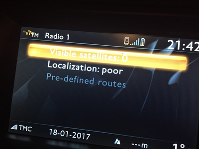

I've just bought a 2010 C5 Exclusive and I have a problem with the SAT NAV. It works but does not show the correct location. The recption says 'poor' and satalites say 0 which i'm guessing has something to do with the antenna.
Anyone had a similar issue that can help resolve it? VIN is VF7**************[VIN obfuscated, can be read by forum staff]

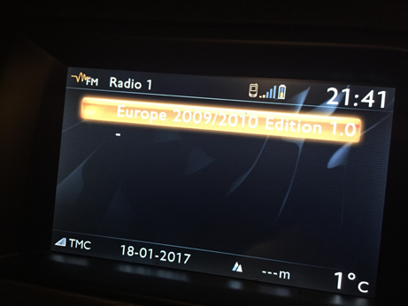

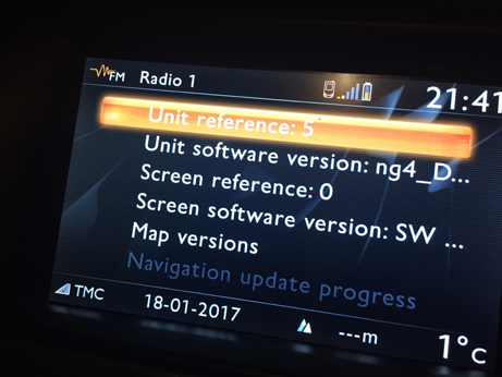

How do I find out what map version I have?
- x 6962
Re: Navidrive 3D
Ok, so Navidrive 3D confirmed. That photo shows the firmware version you have and is probably one of the earliest versions there is - we are now on N42.03C which is the latest one. To find your map version, you just need to hold down the SETUP button with a long press until you get the extended menu. You should be able to scroll down to get the map version.

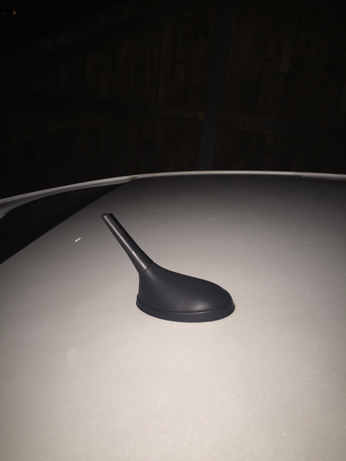

I have a question - do you have the original aerial on the roof? It should be the small black one as in this picture (a bit hard to see I know)

Yes, i think its the original aerial and mapGiveMeABreak wrote:Ok, so Navidrive 3D confirmed. That photo shows the firmware version you have and is probably one of the earliest versions there is - we are now on N42.03C which is the latest one. To find your map version, you just need to hold down the SETUP button with a long press until you get the extended menu. You should be able to scroll down to get the map version.
