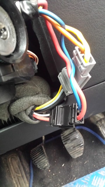

I've noticed on the 306 models on the barrel there either 2 or 3 wiring connectors meaning 6 pin or 4 pin with 2 in each.
My 306 hdi only has 2 connectors so 4 pins and 4 wires.
So whats the situation with this do I need the matching one or will there be a spare connector not used?
Pictures and links below Thanks
This mine 2 connector in my own car.
These 3 connector type 1993 to 2002
http://www.ebay.co.uk/itm/Peugeot-405-P ... Swu1VW4WPh
There is also a 2 connector type but says older models 1993 to 1997.
http://www.ebay.co.uk/itm/Ignition-Star ... XQNo5TZOF8

I think there's a phase 3 (MK3) switch as well so its likely the 93 to 02 is just labelled like that badly ?
Interestingly if you look on servicebox at the early ones it shows two types (but these are to order or random) and later ones it does not show anything the page is empty no part number.

I have asked on the 2 big main 306 car forums and struggling to find out the difference to.spider wrote:I think there's a phase 3 (MK3) switch as well so its likely the 93 to 02 is just labelled like that badly ?
I do have more detailed tech data but I can't get at it at the moment to see what is really going on.
It could be label wrong like you said. I'm thinking the 2 connectors as long as both connect in to my 2 it should work more chance then with the spare 3rd connector?

I've just been to the scrap yard today. I can confirm that 2 306 diesel models there was a V reg hdi 1999 it had the 2 connectors and 4 pins. Then I seen the older diesel xud R reg 1997 with 3 connectors and 6 pins.
So I will go for the 2 connectors with 4 pins matching mine now.
The ebay listing for years is wrong.
