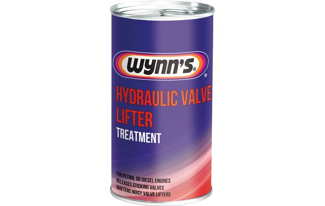

1st thing I would do (if it is not self destructing and really loud) is to use this...

Hello to all , will try the product - thanks.
