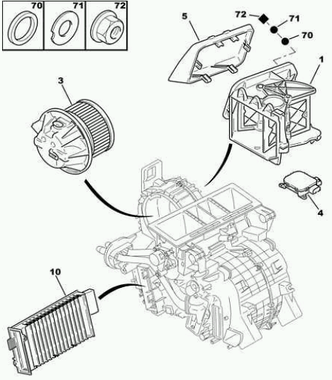

Ok, first there are significant differences between the Mark I and your Mark II. For a start yours has Dual Zone Air conditioning and the Mark 1 doesn't, so there are additional Reduction motors on the Mark II and are different parts completely.
On the first picture, the reduction gear is identified as parts 1 and 2. There are two part 2 units, left and right - so would suggest that your left hand one is possibly the faulty one. There are 2 units on each side of the vehicle. On each side there is one unit for the air distribution (2) and another unit (3) next to it for the mixing flaps. So you'll need to do a bit of testing to see if it is either the air that is not blowing on the left or the whether the air is remaining at the same temperature, depending on how you have set the air distribution control.
Getting to these may involve taking the passenger glovebox off, unless you can get in by removing the passenger footwell trim (gearbox side) and getting in and above to the right of the pollen filter (the cartridge looking slot shown where the (a) is on the picture - but there are 4 bolts holding each of these units on.
